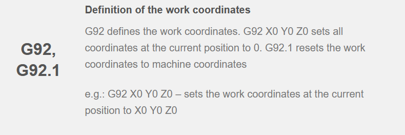

    Thank you, Misterg. I have attached an image. I would instead send a command (serial console) then use the jogging buttons, as I end up crashing these axes for my laboratory desktop CNC machine. I have attached a picture of the machine.
    I am getting very confused when I jog.
    But when I use a G92 G0 X2 command, for example, I can understand. I will also do further tests using my digital dial gauge to re-check how much the axes move.

    I'm not sure why you are using G92, and I don't believe you are using it correctly - it is for setting the workplace zero for the current wcs. Did you mean G91 (relative move)? If so don't forget what @David the swarfer said about G90/91 being modal and the need to set it back to G90 for absolute movement mode.

    So am I correct that for my machine, wherever the X, Y and Z-axes are sitting in space, if I run the command/g-code "G92 X0 Y0 Z0" sets my machine at "X=0", "Y=0" and "Z=0". Am I understanding you correctly?
    I like to test and send commands before just running g-code.

    I don't use it myself, but that is my understanding. If you want to move relative to where you are now then use G91, but most control software will do that for you if you are just using it for jogging (and put the movement mode back to absolute (G90) for you.
    You seem to be making an awful lot of extra work for yourself, although understanding g-code is a good thing in my opinion. :)

    do NOT use G92
    yes it creates offsets (sets your displays to 0), that may be useful in some cases, but it creates GLOBAL offsets that mess up every other offset, including tool length offsets.
    Because it is global is will BITE you at some point because something unexpected (and possible expensive) will happen.
    The correct way, without sideffects, is to use the 'setZero' buttons built into the OpenBuildsCONTROL program (and all other GUI programs for GRBL controllers).
    These set the offsets for the current WCS and do not sideeffect tool offsets or anything else.
    These are what your CAM program will be expecting to be in effect.
    (the setZero buttons use the G10 L20 Pn ... command , which is the correct one to use G Codes )
