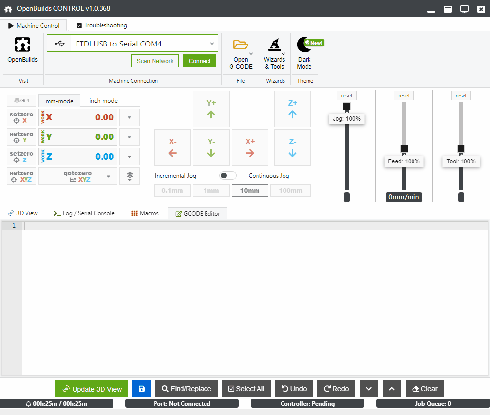

    Just to circle back to this issue - I found something by accident today. I needed the simulation feature to validate my tool path for an operation, so I turned on the 3D viewer after I had already loaded the Gcode file.
    And what do you know, it fired right up and didn't smash my CPU for 5 mins like it does if I load a new Gcode file with the 3D viewer already on.
    This strongly suggests to me that there is an "order of operation" issue in the Control software (and is being masked by those with fast CPU's). Yes, my CPU can't pull the skin off custard, but it's clearly not so slow that it can't run the 3D viewer.
  21. Peter Van Der Walt
    14,482
    4,209
    Sample file to reproduce? Only one that really does slow down with viewer, and really does not with the above procedure. Reproducable examples are the only good way to find rare observations.
    Also remember to measure both ops. File load > into gcode editor (takes a bit of time to render the colored markup too). Then renders in 3D view.
    Taking a break between the two and measuring only the second is not objective :) in the usual workflow at all happens in one "period" of waiting. So do add up the two periods :)
    Yes just 3D view will be faster, as it already loaded into the gcode editor earlier...

    Ok, I've replicated it for you, with reboots in-between the 2 major tests to ensure fairness (Gcode attached).
    On average, it takes 1 minute 30 Seconds for my laptop to start responding again if the 3D viewer is enabled, vs instant Gcode loading with it off. It takes only 10 seconds to turn on the 3D viewer and wait for the app to restart itself and load the 3D view data.
    In a nutshell, there is 1 minute and 20 seconds of missing time being wasted here by something being amiss in Control with the 3D Viewer enabled?
    EDIT: just fixing the video, somehow I only uploaded half of it.
    EDIT 2: and Fixed - sorry for the video quality, one of the fluro's in my garage is out and the poor lighting makes for a grainy video.
    #2363 dJOS_500, May 9, 2023

    Unable to replicate, all three test files loads in super fast time over here (realtime GIF below out of Screen2Gif) test not replicated.gif |
    PS: some of the load time is hidden behind the splash screen on refresh
    Sidenote? Is that Windows on a Mac?

    I timed the entire reload process from the time I clicked off the "disable 3d viewer" option to the time Control showed the 3D view. It was 10 seconds (you can verify that by timing the video).
    Yes, it's Windows 10 on an old MacBook with a 2 Ghz Intel Core 2 Duo, 6 GB Ram and a 250 GB Samsung SSD. The fact that it's a Mac running Windows is not relevant, nothing else I run on it has any odd behaviour, and I'd never had any issues with Control until around the time the UI got Dark Mode (which I very much like).
    Btw, what system specs are you testing on?
    PS, I can't replicate it in a dual core VM (HW = i5 Hex core), but I'll dredge up an old Dell Core 2 Duo I have lying around and try that.
    #2369 dJOS_500, May 9, 2023
  30. dJOS_500
    dJOS_500 Journeyman
    Jul 16, 2022
    270
    120
    Ok, so I fired up my old Dell OptiPlex 755 with a Core2Quad @ 2.8Ghz, installed a clean copy of Windows 10 Pro onto an SSD, and OB Control instantly loaded Gcode files and showed the 3D view. So I took out the Quad and installed a Core2Duo @ 2.4Ghz (so only 400Mhz faster than my MacBook), and same thing. :jawdrop:
    I'm beginning to wonder if my OB Control install on my laptop got corrupted during an upgrade somehow. ‍:eek:
