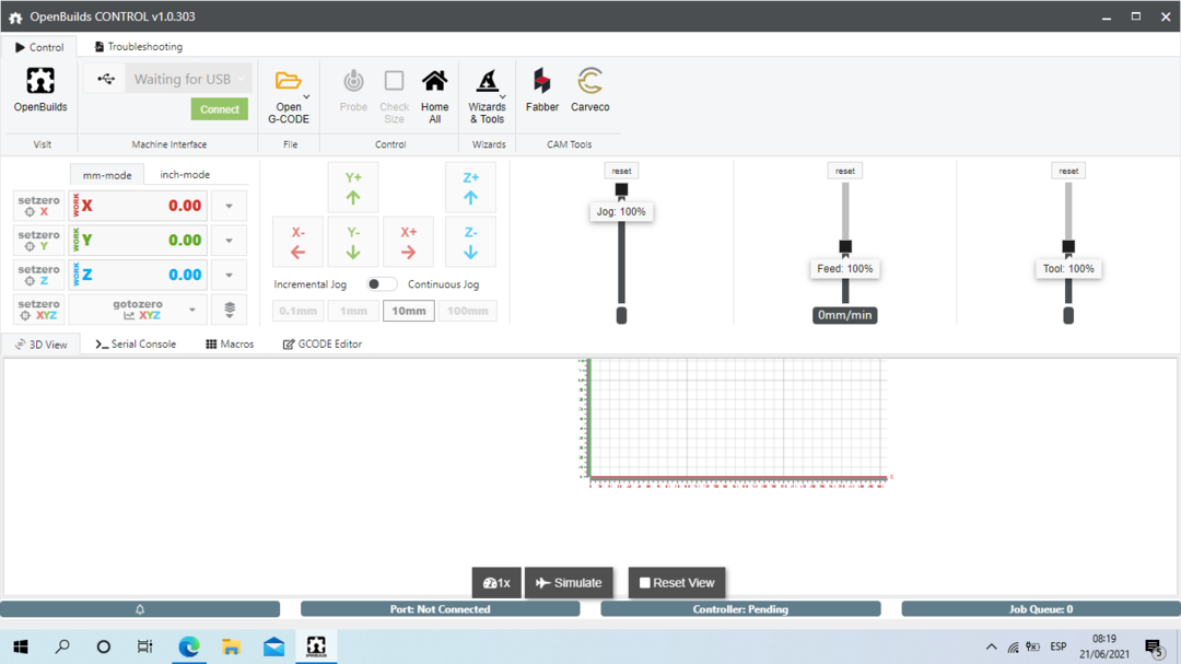

    CUANDO CONECTO EL CABLE USB NO ME DA OPCION DE CONECTAR . Y CUANDO CONECTO EN OTRA COMPUTADORA SI ACCEDE, CREI QUE ERA EL PUERTO USB PERO YA LO REVISE EL PUETO SI ESTA BIEN

    See section 7 of the OpenBuilds Rules at Terms of Service and Rules | OpenBuilds - ENGLISH postings only please
    Also see the BlackBox Documentation at docs.openbuilds.com/blackbox - drivers are discussed in section 4.1 and 4.2

    Ignorant newbie here, recently purchased a machine, built it and started following along with the software tutorial and right off the bat it's showing "waiting for usb". I've plugged into all my ports and nothing. I'm so lost S.O.S.

    See docs.openbuilds.com/blackbox - sections 4.1 and 4.2
  11. Vob Bila
    Vob Bila New
    Jun 28, 2021
    hey thanks, I just had to dload a driver, I got her fixed up and already test carving. thanks again
  12. Peter Van Der Walt
    14,571
    4,230
    Driver is section 4.1, dont skip 4.2 or windows power management will shutdown your USB portd mid-cut at some point. Read the documentation please, it will help you avoid expensive mistakes :)

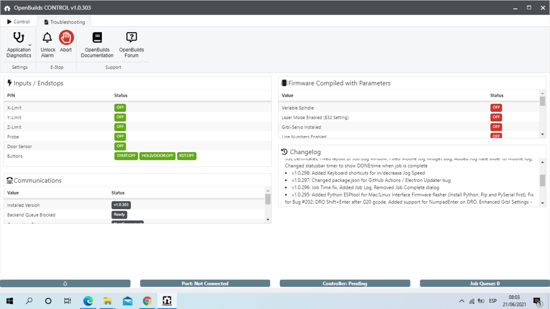

    Hi there,
    I have "commented out" using variable speed in the config.h file, recompiled and then uploaded to the Arduino UNO, but the CONTROL software still shows "variable speed" as being active.
    What am I doing wrong?
  25. Peter Van Der Walt
    14,571
    4,230
    Grbl reports it based on whether #define VARIABLE_SPINDLE is defined or not

    I agree but the section in my "config.h" looks as follows:
    // Enables variable spindle output voltage for different RPM values. On the Arduino Uno, the spindle
    // enable pin will output 5V for maximum RPM with 256 intermediate levels and 0V when disabled.
    // NOTE: IMPORTANT for Arduino Unos! When enabled, the Z-limit pin D11 and spindle enable pin D12 switch!
    // The hardware PWM output on pin D11 is required for variable spindle output voltages.
    // #define VARIABLE_SPINDLE // Default enabled. Comment to disable.
    I commented out the last line. Is that not sufficient?
    Thank you for the help.
  27. GS76
    GS76 Well-Known
    Mar 22, 2020
    151
    33
    Hi Peter,
    When I wired the UNO according to the following instruction the "variable speed" was now turned off.
    It is counter-intuitive! I will keep checking.
