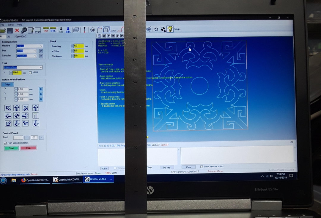

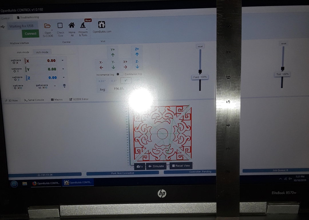

    Okay here are two pics open full size on a 15"w laptop. Once is of open builds with only about 3" of screen for the build plate. The other pic is GrblGru thats showing about 5" of screen for the build plate. The openbuilds has a lot of open space unused space that could be put to better use.
    I'd prefer to use a program that was specifically designed for the Blackbox than having to try and tweak something else.
    Thank you for looking.

    What is more important. The 3D view or the interface, buttons, etc. What does the viewer do: it shows you which file you loaded, and allows you to inspect the gcode a little. That's all. What really counts is being able to see the DRO, and have decent buttons that work on a touchscreen too. The 3D view is significantly less important, because it is also less usefull, than the other elements on screen. Accordingly thats how screen real estate is divided.
    Also, it has to fit every user, so compromises are to be expected. Some people have widescreens, some do not. Etc
    Having the extra width is awesome on the 3D viewer too, just hover over the viewer and turn the scrollwheel on the mouse: see how it uses the extra space now (;
    Reposition the view using middle and right mouse button drag
