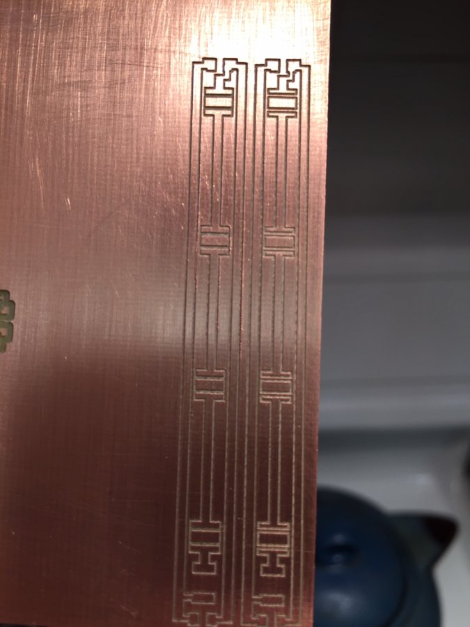

  25. ClaudeJER
    ClaudeJER Well-Known
    Oct 2, 2018
    39
    27
    Here's my results with my Lead machine, Dewalt router, XPro V3 controller, ESTLCAM application and machine controller, the PCB was originally made with Solidworks then I switched to Fusion360 to get the DXF file, I find that Fusion 360 is a lot more "newbie" friendly and somewhat intuitive.
    My only complaint with the machine is the noise level from the Dewalt router. I am looking into a 1.5 KW VFD system, we'll see...
    The dimensions of this board are 6.35mm X 76.5mm:
    BTW, Thank you guys for your help, I greatly appreciate.
    Claude.
