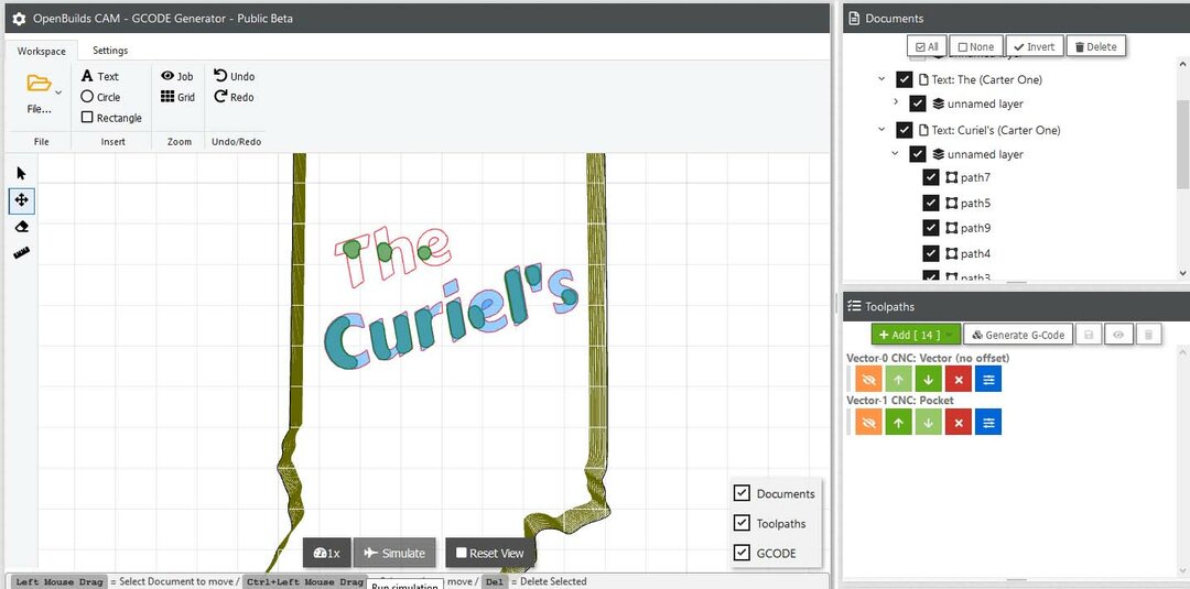

    I cannot figure out why the pocket or inside cut wont generate G-code to cut the material out of the text. It only shows cutting out a section of the text. I have it set to 1mm cut per pass with a total depth of 3mm. I am using the openbuilds Cam Gcode generator and used the text tool from the workspace.
    I have tried different options and referenced other files, but have no idea where the problem lies.
  17. Peter Van Der Walt
    14,571
    4,230
    Your endmill is just too big to fit in there thats all. It mills away what it can. Use a smaller endmill, or scale up the drawing so the endmill can fit in there
