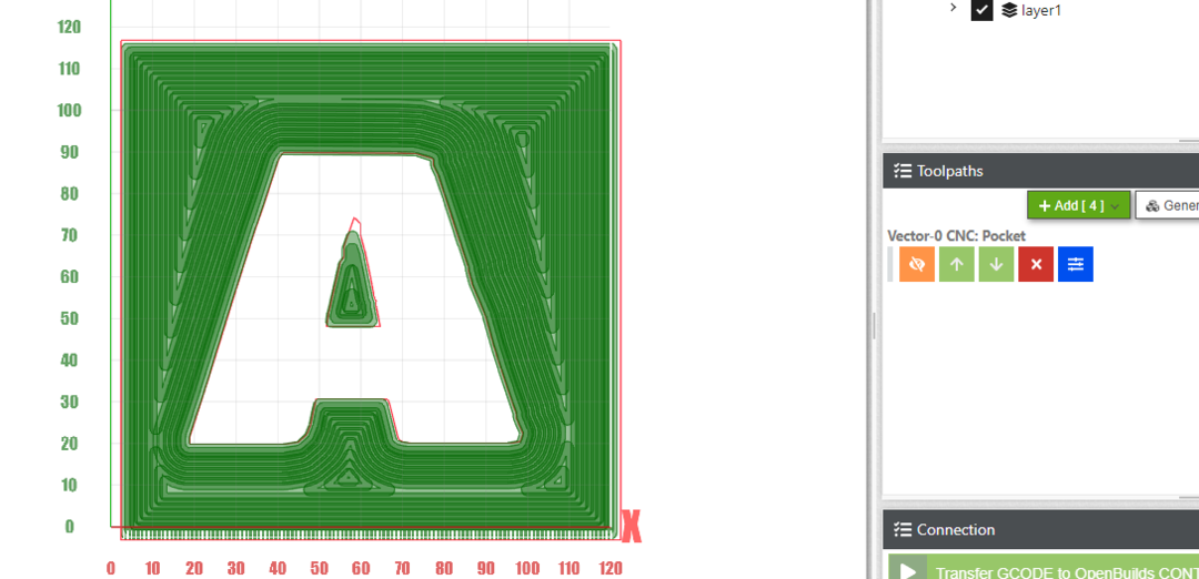

    Hi Peter - new query - is it possible to create a pocket (eg square) with text inside it that is left proud (ie it pockets the space between the square and the text outline) ?
    13,749
    4,070
    Certainly yes. Select inside and outside lines both, then create pocket. Clipper algorithm will exclude inner shapes from outside shapes to calculate the pocket (odd/even algorithm finds shapes inside shapes and alternates which to assume inside and which outside - very clever see below, pocketed around the A but also clever enough to know to pocket the inside of the A in that case (;
  3. Rich Ricket
    May 28, 2020
    Magic, thanks again for the very quick response. I was getting some interesting results - I hadn't realised I needed to select "merge geometry" and I had to experiment with stepover - but looking good now :)

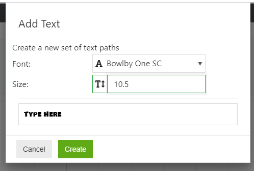

    Another question, Peter - can't seem to go smaller than 20mm height text, can I change these settings ? Got to make some labels for a friend's boat switch panel.
  6. JustinTime
    JustinTime Veteran
    Dec 18, 2013
    756
    252
    Could it be that you can't go smaller because of the bit diameter that you use? Maybe a smaller bit diameter will let you make smaller letters?
  7. Rich Ricket
    May 28, 2020
    I can't find a mechanism - the bit diameter's set after inserting the text, text size starts at 20mm. I'm using a bit diameter of 3/64". I thought that previously I'd been able to set pretty much any text size. Any help much appreciated !
  8. Rich Ricket
    May 28, 2020
    ...it looks like the options for text size are limited to 20, 30, 40, 50, 70 - is this just a programming restriction, could the list be expanded to include some smaller (say down to 5mm height) and maybe larger sizes ? That'd be great if possible...

  12. Peter Van Der Walt
    13,749
    4,070
    Changed it from a dropdown to a Input, you can type in any size you want:

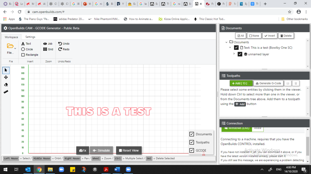

    Screenshot (198).png I have recently finished my Acro machine and have successfully completed the hello world example provided, however when it comes to doing the first job I realize I have no idea how the tool paths work or how to set them up.
    Glad of some help thanks
    #171 Reagan Frizzell, Oct 13, 2020
  22. Peter Van Der Walt
    13,749
    4,070
    Select vectors with the mouse. Click Add under toolpaths to add a Toolpath. Setup parameters. Apply. When all toolpaths are set up, click Generate Gcode
