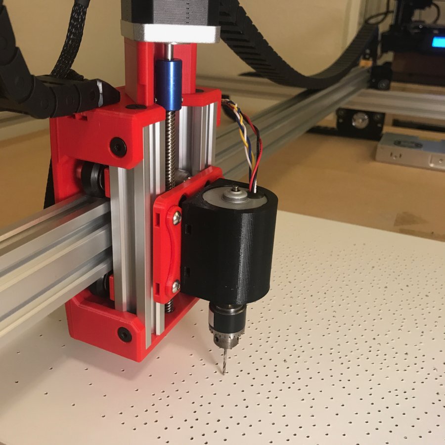

    Nice addition! What are you milling with this setup? I am interested in acro because I can find a kit in my country, in order to mod it like you did just to be able to mill pcbs.

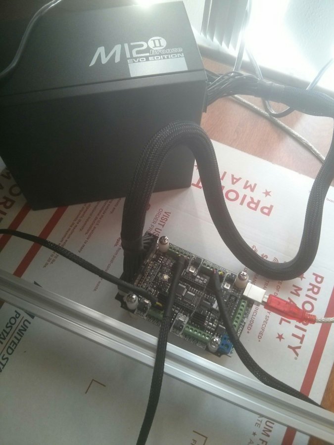

    Dear Mark Carew,
    I am having the same issues has ChuckD. X axis is not jogging but does like a grinding noise with a back and forth movements. I have changed out the stepper motor and also changed out BLACK BOX to another BLACK BOX and get same results. I have taken the Arco 55 apart and reassembled it many times. Could this be a wiring issues? I will be connecting one of my BLACK BOXs to the ARCO 1010 to replace the XPRO cause it doesn't work with LIGHTBURN SOFTWARE YET. I have watch the youtube videos to assemble.
    PLEASE HELP! Thanks RogerS
  7. Peter Van Der Walt
    14,037
    4,119
    That sounds exactly like the symptoms you'd suffer when only 3 of the 4 wires to the stepper motor have good contact. Redo/Check your wiring, any joints/extensions/connectors to make sure all 4 wires are tight and have continuity. Also make sure your wire order is correct (a coil on pins 1 and 2, and the other coil on pin 3 and 4: Use a multimeter in continuity mode to check your coil pairs, don't 100% trust the color codes
  8. rksmith21
    rksmith21 New
    Feb 19, 2018
    Peter
    I would like to say thanks for the help. The issue was on the 4 pin connect that was used to plug into the Black Box for the X axis. Yellow pin wire was to far in so was touching the wire jacket. So my Arco 55 is working good. image.jpg

  10. Peter Van Der Walt
    14,037
    4,119
    That one is really hard to spot! Great job on finding that! Glad you are up and running!
