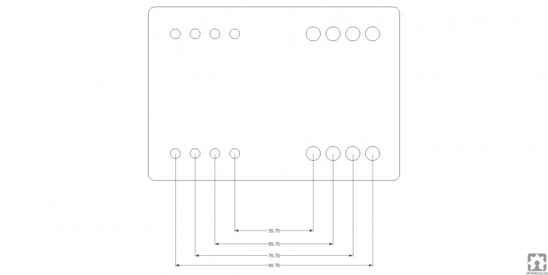

  12. Derwin Palacpac
    Jan 22, 2014
    14
    Fantastic, the issue im having has to do with the amount of weight the router/spindle has. Because i used a water jet to machine my z plates, i think it bored the hole too big which resulted in the spacers being a little too far apart, thus resulting in the router bit not squared vertically. so at max the eccentics i have needs a taller lobe and the wheels can grab onto the extrusion tighter.. Right on.. I was worried that i would need to mill another plate or revert to using the v-wheels. I'll keep an eye out for the taller metric eccentric in the parts store..:thumbsup::D
  13. Mark Carew
    2,750
    2,423
    Hello @Derwin Palacpac I hope I haven't giving off the wrong impression that the new eccentrics will have a larger swing on the wheels eccentrics adjustment they will be the same. You may need to move one set of holes in to make up for the slop in the water jet cut.
    The spacing on any given plate should be as shown in the picture below
    or in the resource model here: http://www.openbuilds.com/resources/sketchup-v-slot-model.57/
    Hope this helps
    Mark
