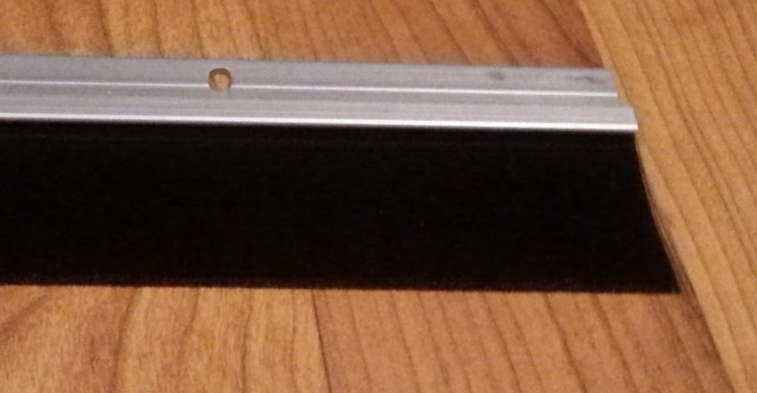

    This is the door sweep

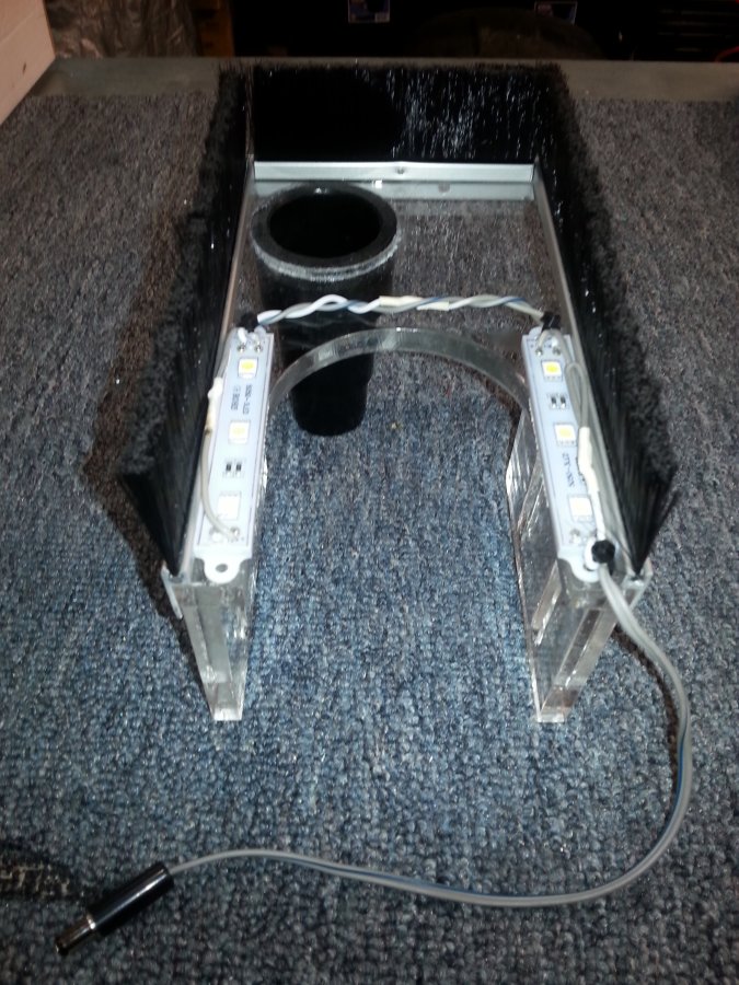

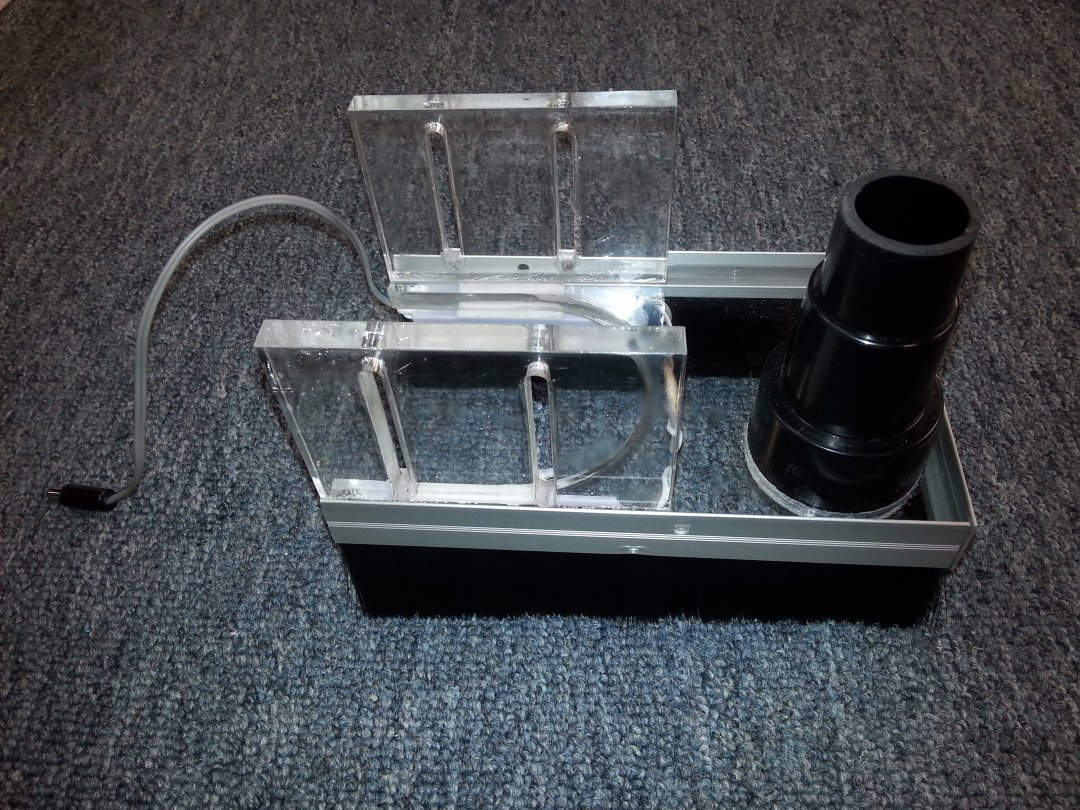

    So, I had some more time to work on this last week, and came up with a passable imitation of an actual dust shoe.
    I cut a base plate from 8mm clear acrylic. Then I cut two side plates that were about the same length as the side of a router mount. I then proceeded to butcher some slots into these plates that will fit the tapped holes in the side of the router mount. Believe me, it's not as easy to machine acrylic as it looks. I tried a couple of different bits, but got pretty poor results. I think the main problem was too low a feed speed, and to high a router RPM. I was just using my fixed speed Bosch Colt, so that was part of the problem. I am going to have to practice on some scrap to get this down. Anyway, they are good enough for the kind of girls I go out with...
    I then used hole saws to cut a 3" hole near the back for router clearance, and a smaller 1.5" hole for the hose connector. I cut the large router hole into a slot so the shoe could be slipped on over the router without disconnecting anything or disturbing the router mount. The hose connection is just a vacuum hose multi diameter adapter from the local woodworking store, with the flange cut off, glued into place. I put it off to the side and the front as far as I could so you could see what the router is doing without it being in the way. BTW, hole sawing acrylic is another PITA, it keeps melting and clogging up the saw, even at my drill press's lowest speed.
    I then glued these side plates onto the base plate, after bolting them onto the router mount to maintain the correct spacing. I used Methylene Chloride to glue them on, nasty stuff but small enough quantities to be relatively safe.
    Oh, by the way, to get a nice smooth clear finish on the edges, just sand them down nice and smooth to about 220 grit, and then use a small butane torch to "flame polish" the edges. This is also tricky to do without setting the acrylic on fire. Keep the torch moving, and quickly...
    After letting the glue dry, I cut and mounted the brush sides on with some 3M VHB mounting tape. Love that stuff. Sticks like poop to a blanket. Note that the brush is just held into the aluminum channel in one spot with a dimple hammered into the channel. You will have to add new dimples for each cut piece to keep the brush from sliding out.
    I then mounted a couple of 3 LED strips that I bought under the top, one on each side. These are 12v strips, so I wired them in series to get a strip operated from 24V, which I then wired directly into the motor power supply. A pair of 2.1mm coaxial connectors allows the wire to be disconnected to remove the shoe.

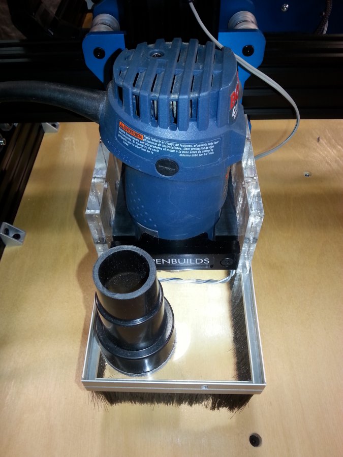

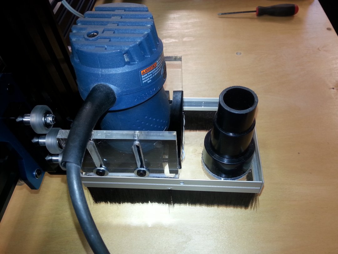

    Here are a couple of shots of the shoe mounted on an OX. Works well. Note that there is no brush on the back, as the shoe slides on from the front and can't have anything in the way across the back. Need some air flow room in order to get good suction anyway.
    Works well, there is lots of adjustment for different length bits and router heights, and it seems to collect dust really well.
    Overall, it works good, but it's a bit of a pain to take it off to change or adjust bits. You have to remove 4 screws to get it off. I wanted to do a magnetic mount with some rare earth magnets, but I didn't have time to figure out an easy way to do it. I think next time instead of using 8mm acrylic, I will use two pieces of 6mm with pressed in magnets and mating flat metal washers. Lee Valley Tools make nifty little magnet cups and pole washers for various sized rare earth magnets that they sell. with the top part mounted on the router, and the brushes mounted on the bottom part, it would be simple to just snap off the brushes to get at the router for bit changes.
    As someone mentioned, I would like to use thumbscrews for the mounting, but so far haven't found any in M5.

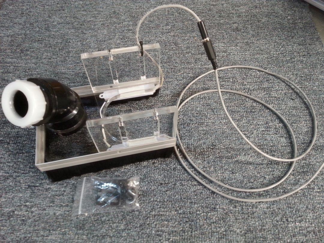

    I have a vacuum port on the ceiling above my workbench. I have a household built in vacuum system plumbed all over my shop with hard 2" tubing so I have hose inlets all over the shop. There is never one more than a couple of meters from my equipment or benches. I just use a short piece of vacuum hose essentially straight up to the fixed pipe. This puts very little stress on the dust shoe.
    I have updated this dust shoe a bit with a swiveling dust port so that the hose can freely swivel to prevent binding. I can also use a 90 degree, 45 degree, or straight port on the swivel depending on where the vac hose is located. The black fitting is able to swivel 360 degrees for a straight fitting, or 180 in the case of an elbow.
