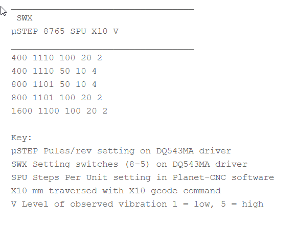

    I am still having some issues with my configuration. You can see my configuration here.
    Essentially, I am not finding any difference with the switches 400-1600.
    Do I have something wired wrong?

    There are some errors on the table you posted. By difference are you talking about the vibration? You are turning off the power when switching?
  8. marmageek
    marmageek New
    Feb 24, 2015
    19
    What are the errors?
    I do an emergency stop to disable the motors, then make the switch changes.

    I think the power needs to be cycled for step changes to take effect, i thought this was in the manual but i don't see it now..
    As for the errors, I take it back, I see now you were troubleshooting by changing settings with the same micro-steps..
    What speed and pulse duration are you running and what acceleration?

    Using the defaults on the Planet-CNC software. Will publish them in a bit.
    Update: added settings export.
  11. marmageek
    marmageek New
    Feb 24, 2015
    19
    Note that I cycled power as you suggested and observed the correct displacement with: 800 pulses/rev, 1101 SWX, & 100 SPU.
    Thankyou for the tip.
