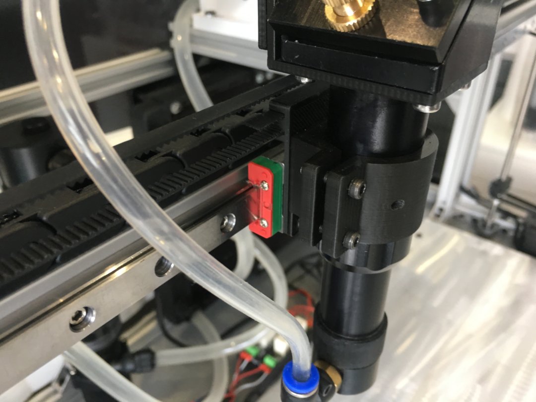

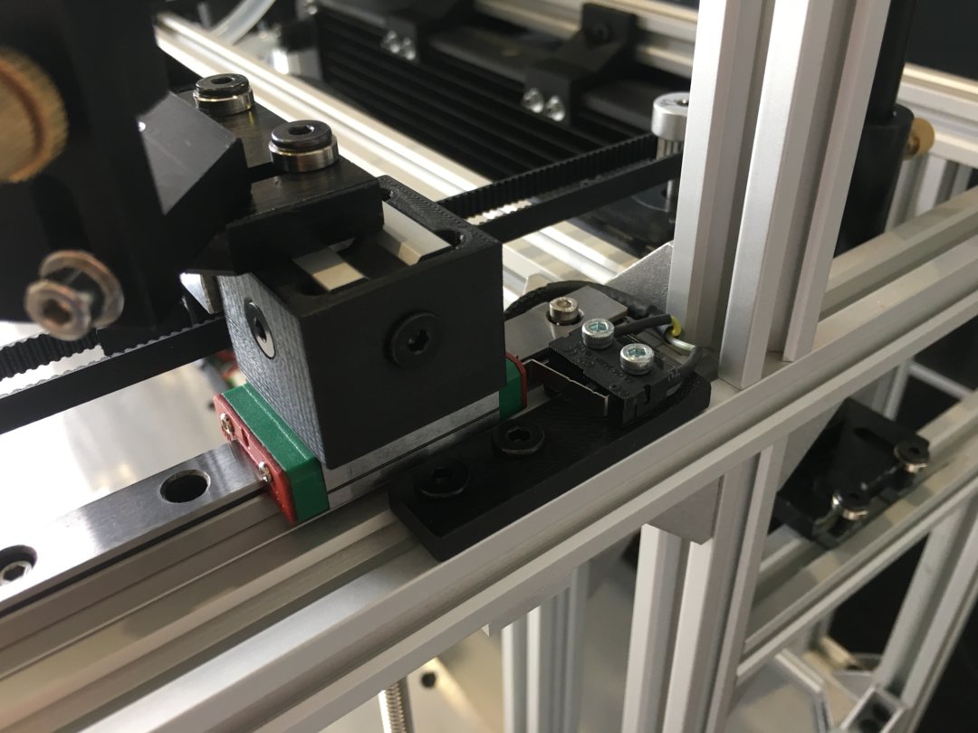

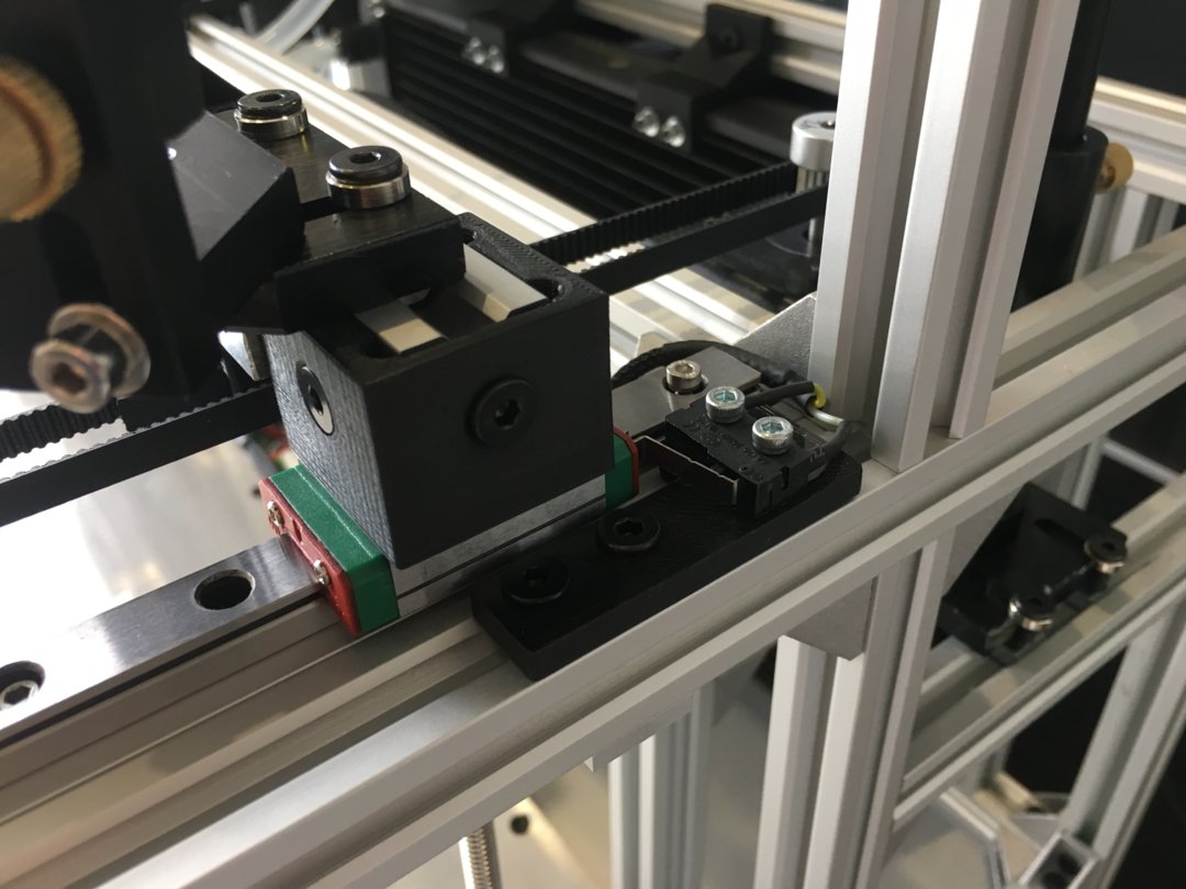

    Thanks for that. Your build looks awesome. Just trying to clarify a few details, You are running linear rails fixed to extrusion? (what size?) Just drilled and tapped?
  5. LukasK
    LukasK New
    Feb 25, 2016
    21
    38
    Thanks:) You are correct, those linear rails are fixed directly to v-slot extrusion. Those are MGN12 linear rails fitted with MGN12H sliding blocks. There is no need to drill or tap anything, rails are already predrilled. Just slide in M3 nut blocks into extrusion and fasten rails to them with M3x8 (maybe M3x6 can remember now) socket cap bolts and rails will sit nicely on 2020 v-slot extrusions. The X axis is the same principle however the 2020 extrusion is attached to Y MGN sliding blocks using 3D printed fixture.

    This photo is actually from 3D delta printer I have at home as the laser cutter is located in my “dirty” workshop. Nevertheless it shows nicely how is the rail attached to, in this case 2040, v-slot extrusion.

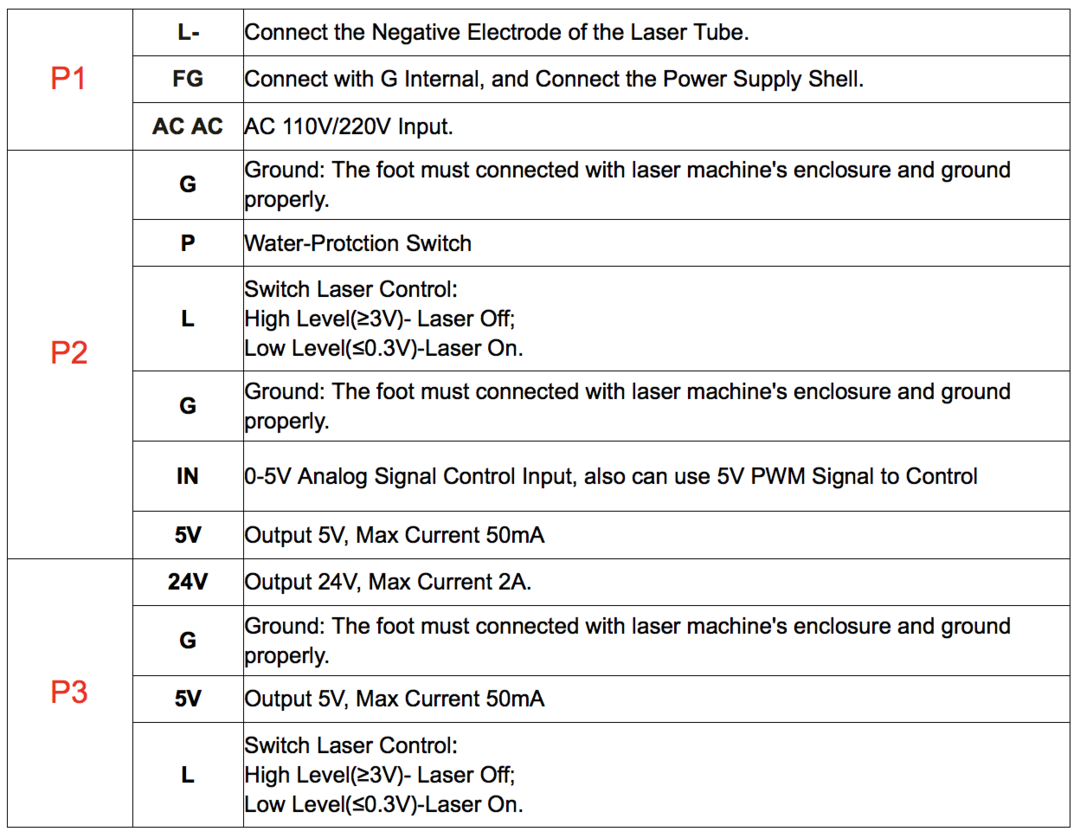

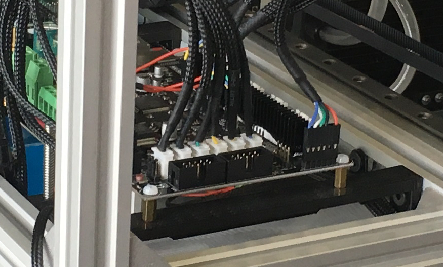

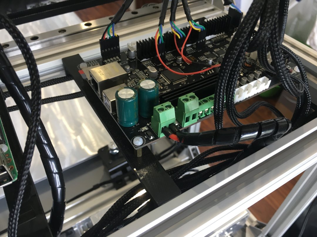

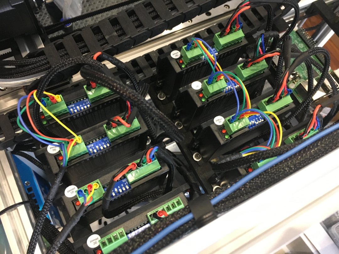

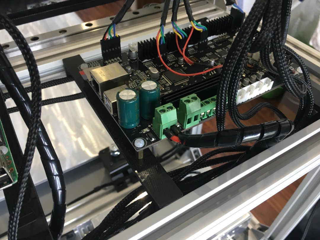

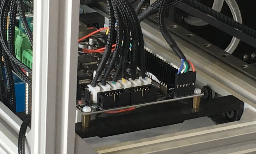

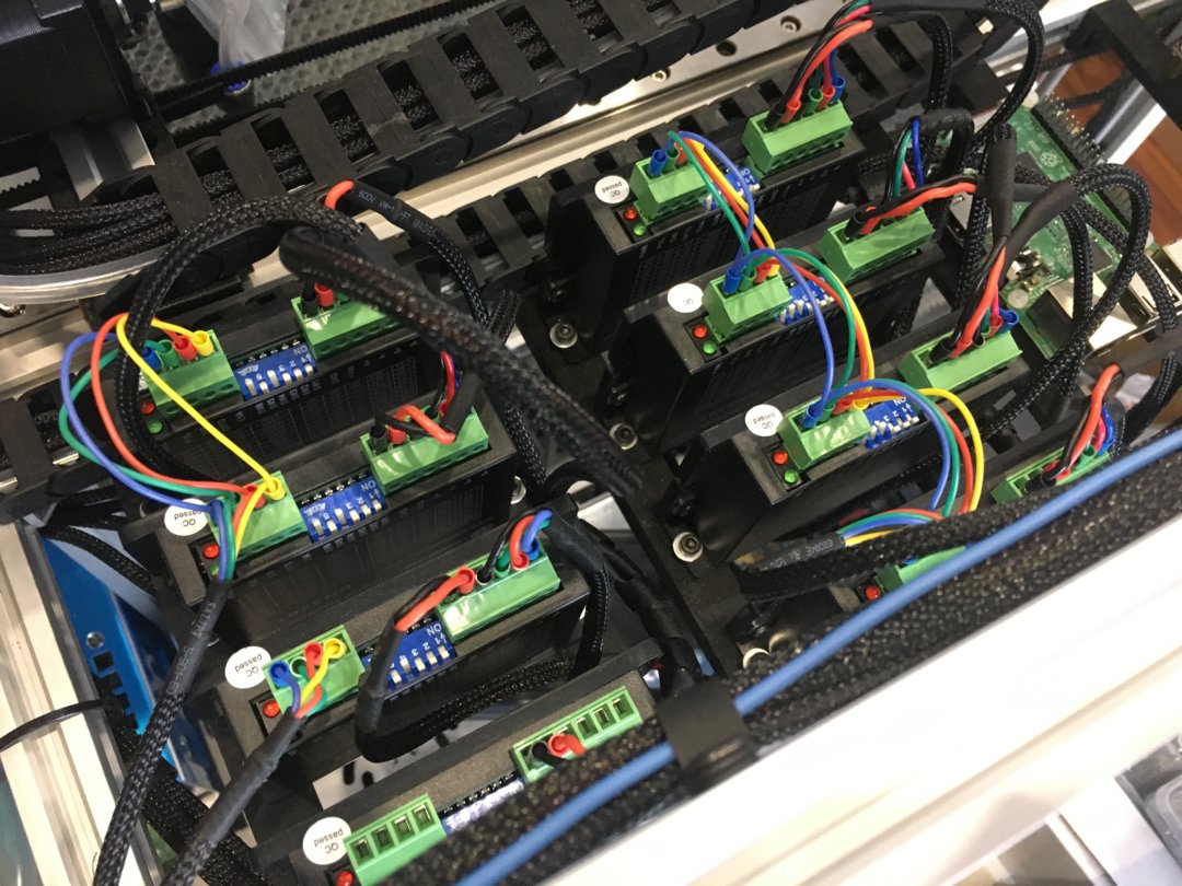

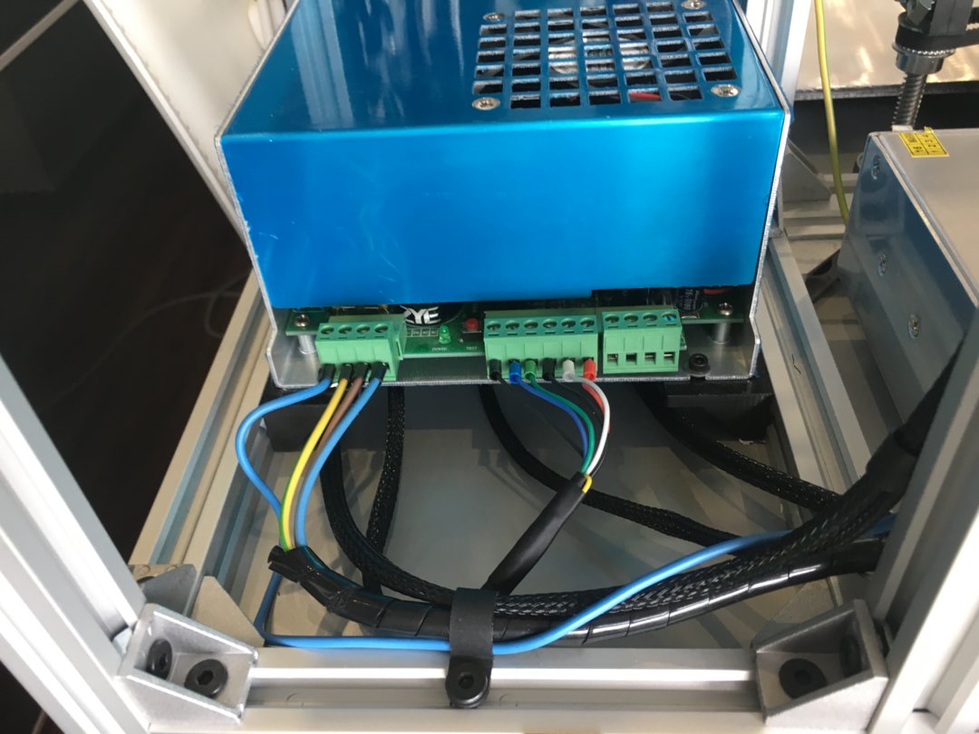

    I have wired the electronics “on the go” so I don’t have any schematics. Anyway I can try to show you the direction. The controller itself is MKS Sbase v1.3 (I’ve donated original Smoothieware) which some kind of clone of Smoothieboard and it is running cnc version of Smoothieware. This combination satisfies my needs - 32bit, USB connection, highly configurable output pins.
    As I have used a lot of stepper motors 17HS19-2004S1 I also used external stepper drivers DM320T. To see how to connect them as open drain you can refer to general-appendixes [Smoothieware]. What took me some time was wiring drivers for Z axis. I had one driver for each of four motors and the logic from controller was connected to each of them in parallel. The problem was that MKS board didn’t provide enough current to run 4 drivers (as a result, the motors run at different speed). Solutions I can think of are two : use one driver for two motors or use some non-inverting CMOS buffer. I have used the first option, was easier one and the driver provides enough current to supply two motors.
    Controller is using 3V logic which fine for all applications in this cutter except one - laser pwm control. The chinese high voltage power supply I have (and mostly all other will) expects 5V for laser power control - bluebox-guide [Smoothieware]. This you achieve by using any kind of level shifter. All the other connections and switch configuration for fans, pump etc. you easily find on Smoothie’s website.
    To have the machine running even without my Mac it is fitted with Raspberry Pi. This RPi connects to MKS usb port, it connects to 7” touchscreen and has the rest of usb ports extended to top panel. I control it either via touchscreen or wireless keyboard. On the RPi Raspbian is installed, it creates it’s own hotspot and runs AFP service so you can upload gcode files. For the control itself I have installed bCNC, LaserWeb4 and Pronterface console and I run whatever suits my current needs the best.

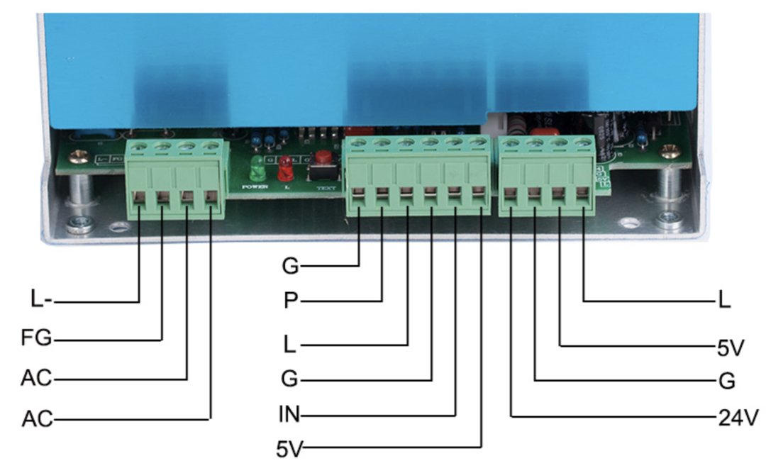

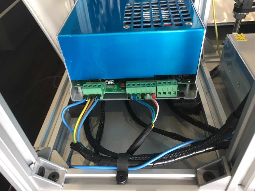

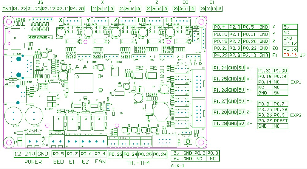

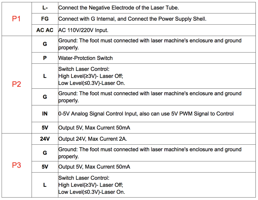

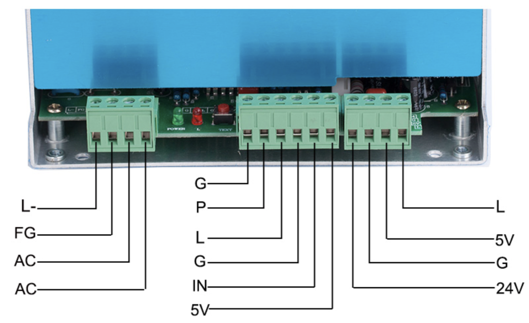

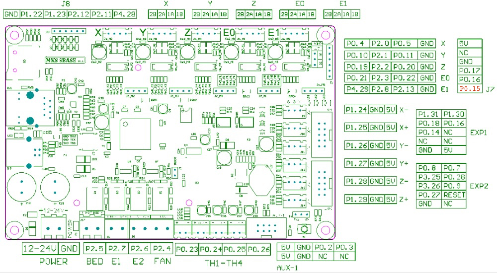

    Finally got home so I can upload some more stuff that may help you in your research.
    When you search for cheap high voltage PSU you most likely find those "blue" on eBay or Ali. Useful pinout with description below. Compare it with my photos to get better insight.
    high_voltage_psu_pinout.png high_voltage_psu_description.png IMG_5754_small.jpg IMG_5739.JPG IMG_5742.JPG
    Maybe the Smoothieware config file I'm running on my setup itself will help you as well. Attached as .txt however on card it has to be placed without extension.
    There are a lot of MKS pinout pictures all over the internet however most of them have one pin labelled incorrectly, that caused me a lot of headaches why it is not working as expected.

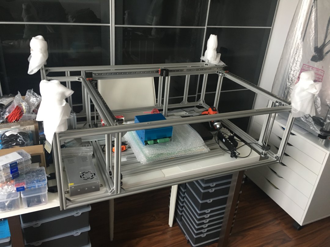

    Many thanks:) Today I have made some "serious" cutting of 5mm PVC and I must say I'm more than happy. Very nice, straight and clean cut with 101.6mm lens (I have another laser head lower part with 50.8mm lens for engraving).

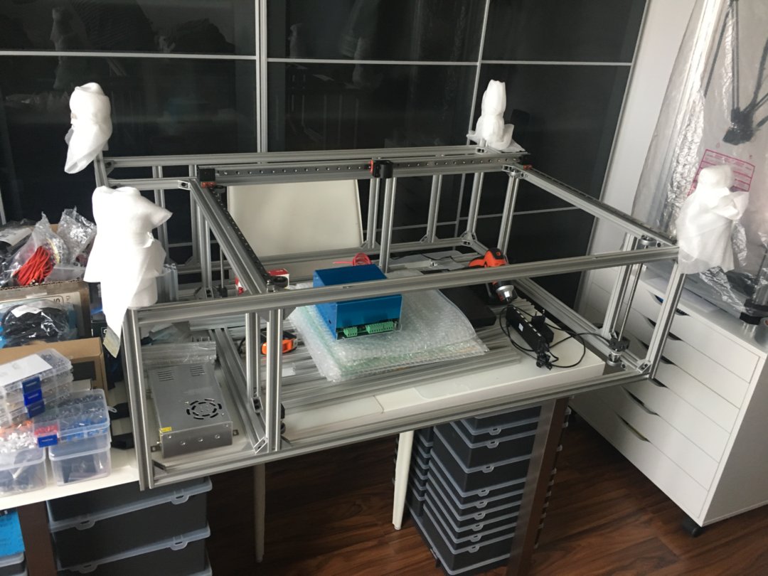

    All motors are NEMA17 size and they are fixed using standard bracket. Only X axis motor is mounted using OpenBuilds motor mount plate. Lead screws are 300mm TR8 fixed using KP08 pillow block.
    The frame is build from different v-slot extrusions lengths as specified in attached SketchUp file. They are attached to each other using 2020 corners, m5 slide-in nut blocks and M5 low profile screws. Nearly every corner has those 2020 corner brackets.
    No detailed part list exists for this build and I actually don't plan to put one together. I have tried to take photos so they show most important parts of the construction, if you would like to know anything specific just ask:)

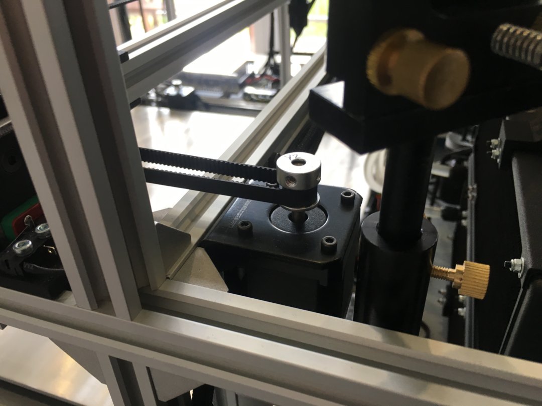

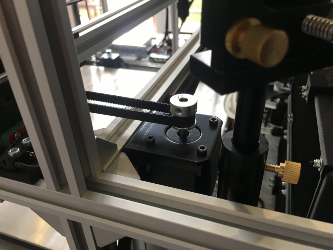

    If you open up the SketchUp file and locate the extrusions where the linear rails are attached you will get the dimenssion. Actually I have shortened them slightly to fit some stops on each end because the linear blocks are very easy to slide off during construction or misuse during operation. On below photo you can see last attaching screw is much larger than it should be, that is instead of those stops which were fitted later.
    Read the thread posts #5 and #6 to learn about fixing those rails to extrusions. The X axis extrusion is attached to those MGN blocks using own design 3D printed part.
    Each side has its own stepper motor controlled through own stepper driver. Right side motor and its attachment :
    Those drives however share the same input from controller so they operate in sync. Those axis are pretty light and powered by 1.8A per coil so no worry about missed steps. Top left 2 drivers are for Y axis wired in parallel, the right most 4 drivers the same use case but for Z axis motors.

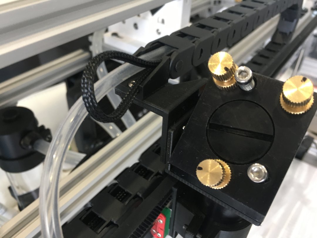

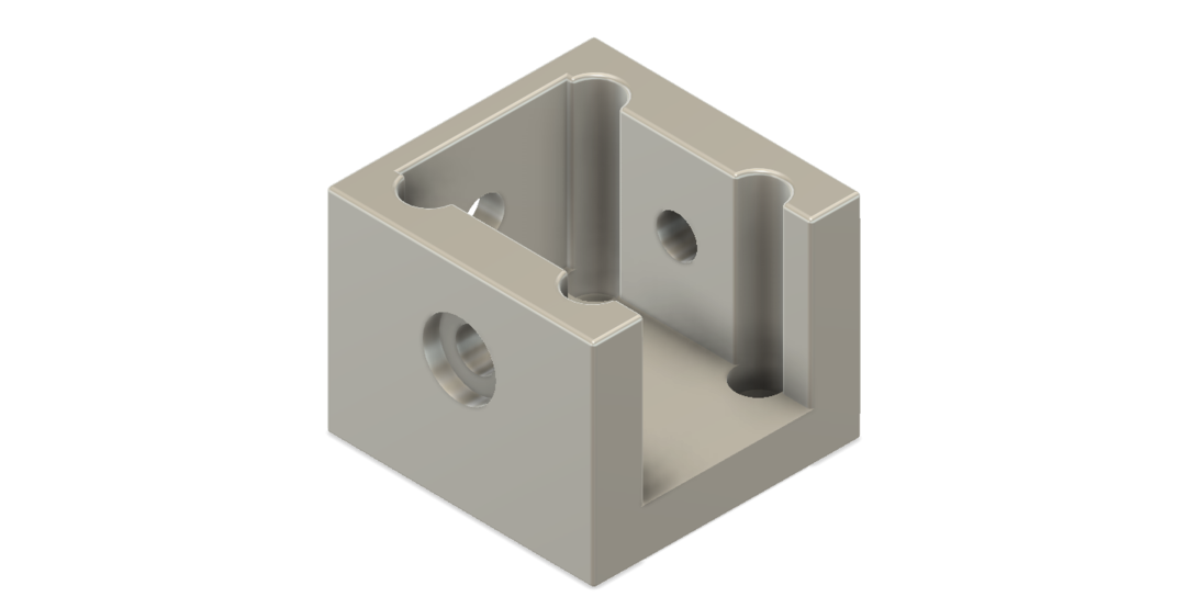

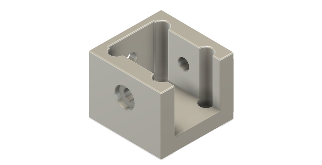

    For drag chain attachment look for laser_head_clamp_dragchain.stl and x_dragchain_mount.stl which are tied together with 2x small M3 hex bolts and M3 square nuts and attached to laser head from the bottom of mirror housing.
    For attaching laser head to mgn12 block dowload laser_head_clamp_mgn.stl and x_belt_mount.stl. Head clamp uses M3 nuts/bolts and clamps to tube directly. Between head clamp and mgn12 block is inserted belt holder. Parts are seperate for easy 3D printing.

    Hi how are you. You could tell us how you made the connection between the controller board and the laser power source. How do you activate the laser? What signal do you use to activate it? You have some diagram. I have the same source as you and that is what is generating doubts now.
    Thank you so much
