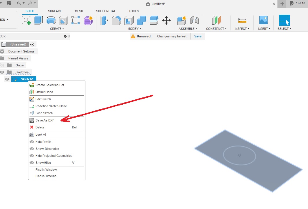

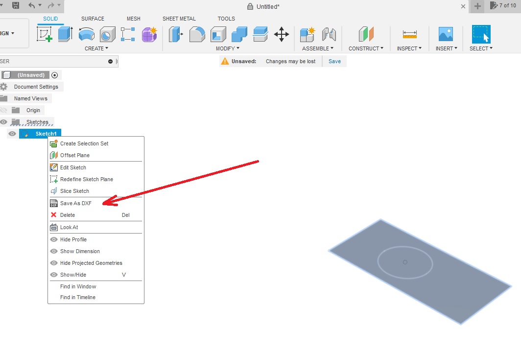

  12. Alex Chambers
    2,700
    1,327
    Yes - you can save a sketch as a dxf file from Fusion (even in the personal use licence version)
    Spark Concepts wiki, in case that is of use ;- Home · Spark-Concepts/xPro-V5 Wiki

  14. dbdb
    dbdb New
    Apr 3, 2021
    16
    I think your screen shot is out dated... I would hope that I am wrong.
    If you attempt a "save" they force you to the standard file format and the cloud.
    If you use the "export" you can save to your desktop, but no DXF without paying. see image below
    Hence my question... what is a normal workflow to cut a profile? several pieces from one piece of plywood?

  17. dbdb
    dbdb New
    Apr 3, 2021
    16
    Alex.... I now think I am wrong!
    I showed in the image that I could not export the DXF.
    I then tried to duplicate your screen-shot at the Sketch Folder level and still nothing.
    BUT, at the individual Sketch level, below folder, Save as DXF is available!
    I saved a test and opened it in OB Cam with no problems!
    Thank YOU!

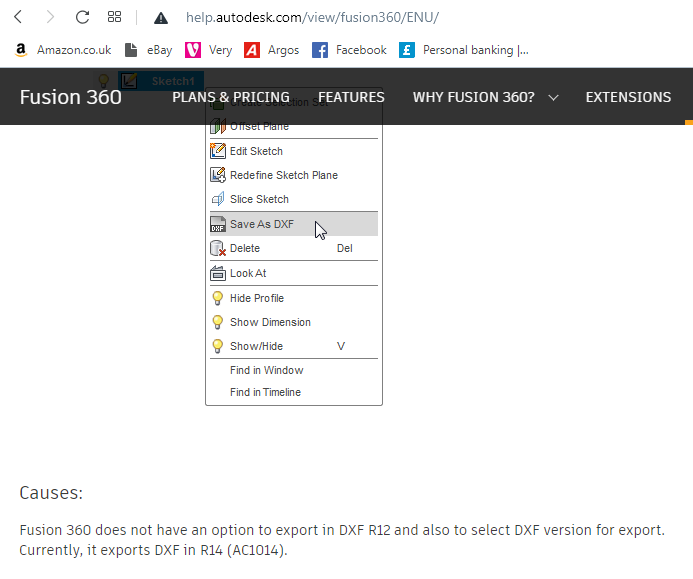

  18. Peter Van Der Walt
    14,042
    4,123
    I am surprised it worked. They used to export as a fancier DXF version than OpenBuilds CAM would support.

  22. Alex Chambers
    2,700
    1,327
    Hmm, I gave that advice because Autodesk say Fusion exports dxf's as R14 - don't use it myself because, as @Peter Van Der Walt says, Fusion cam is good.
    PS - just had a look at a dxf file exported from Fusion - it is R14, don't know how to check if it is using polylines.
