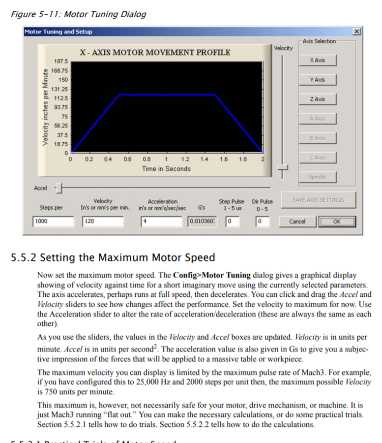

    looking for help with my x axis I am useing mach3 and v-carve pro 10. trying to speed my x up when it carves it really slow my y is nice I have try to set the motor controls in mach3 dose not seem to do nothing stays same speed any help would be great o I am useing mm.

    Check that your accel and velocity are set the same for both axis.
    Increasing the accel is probably most overlooked and important, takes testing to determine best setting for your machine.

    thank you,, I hade found my new driver dip switch was setup wrong now its faster .
