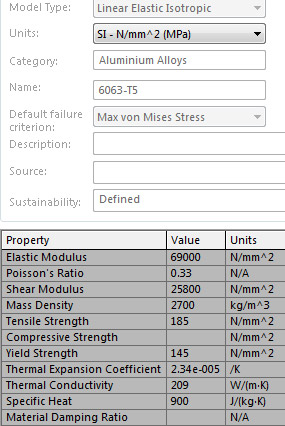

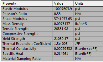

    I am sitting here trying to figure out what I am doing wrong in Soildworks' simulator because none of the numbers I am getting match up.
    Do these numbers jive with what is being written?
    E looks alright to me though it is coming out to 10007603.90337 lbs/in^2
    edit: Here are the same numbers in Imperial
    #25 DarkAlchemist, Sep 21, 2015

    I used 6061 t6. The modulus is the same though. Do you have the ends fixed and are you distributing the force over the entire length?

    Ends are fixed and I used this technique on one of the V-Rail pieces from the library using 6063 t5 -
  28. Joe Santarsiero
    Joe Santarsiero OB addict
    Oct 30, 2014
    902
    196
    The way I did it.
    Fix the ends.
    Also place a narrow surface on top of the beam in the center.
    Under forces choose this surface to concentrate your load.
