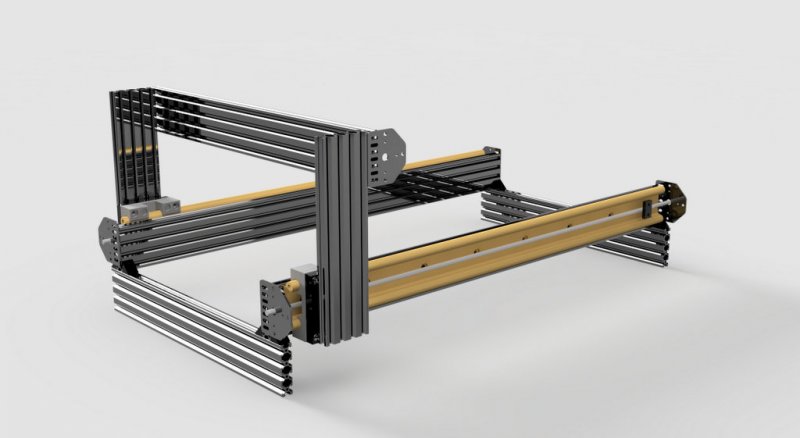

Linear Rail to combine with VSlot Parts 2015-03-13
Commercial linear rail system

    That looks interesting, are you going to try it ??

  3. Iwan Müller
    Iwan Müller Well-Known
    Dec 4, 2013
    36
    64

  5. AlexLee
    AlexLee New
    Jan 15, 2015
    Iwan,
    That's absolutely beautiful, really looking forward to seeing her in action!
    Alex

    Can you give us some more pictures please. Looks really good.
    And what size sliders are we looking at here?

    A really outstanding solution. Which bearings did you choose they have a number of options.

    Looking at the pictures, it looks like he used the Drylin W double rail (part # WS-10-40) and the assembled carriage (part # WW-10-40-10). The only difference between the WS-10-40 and WS-10-80 is that the -40 has single, centered, mounting holes, while the -80 uses 2 mounting holes. The -40 is $54 per 1000mm, while the -80 is $98, which seems like an easy decision to make. As for the carriage, it cost $40, while you can buy the indivdual pillow blocks for $5.25 each (4 per carriage). To me, that's a large mark up for an aluminum mounting plate and some screws.
    I really appreciate you sharing this information, and I think I might have finally decided on the direction for my first build. Any chance of creating a build log?

    Hi SatMike. My feeling is "emotional" based on what I learned in the first build. When I first looked at the OX with two beams for the X axis, I thought wow that is strong enough for me!
    But when you watch the OX in action under cutting loads it was shocking to see the flex across the gantry. So my approach now is save a little longer and over engineer the parts. My concern with the 10mm diameter rails is they are made from aluminum which is not strong or stiff, hence why I priced the larger diameter rails.
    But the 10-80 will be much, much better than the original OX wheel setup in my opinion...
    When I look at Iwan's photograph of his machine the diameter looks like 20mm, but this is a pure guess! You might be right...

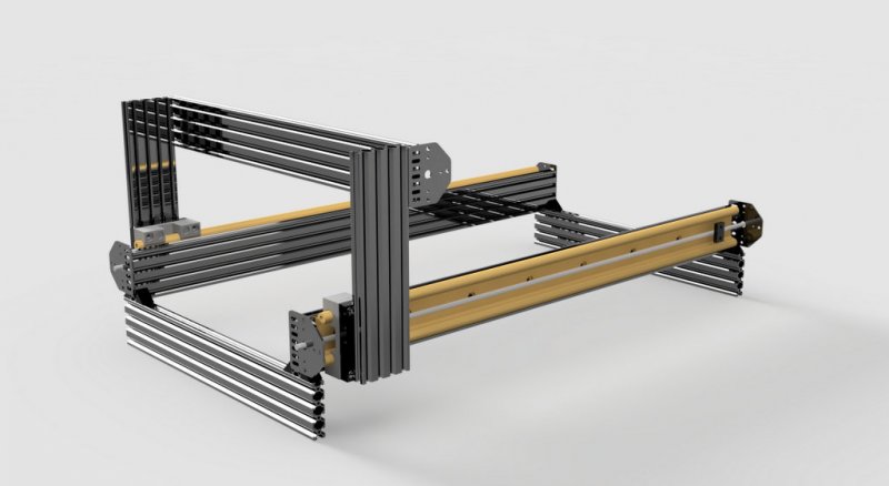

  16. SatMike
    SatMike New
    Feb 12, 2015
    27
    So after looking at the photos some more, I would say Iwan used the 16-60 rail, based on comparing the size of the rail to the nema 23 plate and the fact that the rail is center mounted. The 16-60 rails is $103 per meter, so it's about $40 cheaper per meter than the 20-80 rail. For the rails at 1500mm and assembled carriage, it comes to $209. I think the 16-60 might be a good compromise between size and cost.
    Also, where do you see that the larger rails are not made from aluminum? Everything I see is that all of the Drylin W rails are aluminum.
    I think if I go this route, I will look at using the 16-60 for the y-axis, and the 10-40 for the x. Not only is there a cost savings, but the 10-40 will help keep the weight down on the x-axis.

  18. Iwan Müller
    Dec 4, 2013
    36
    64
    So sorry to answer your questions so late:
    yes I'm using the 16-60. I tried the 10-40 but it doesn't leave enough space for the lead screw and lead screw block, so I think the 16-60 is a good choice.
    crispin and sgspenceley like this.
