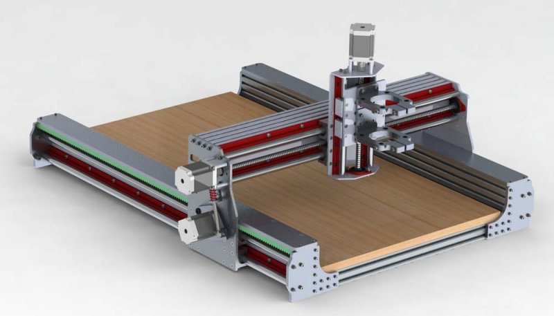

    Thank you this was a lot of 3D modeling, but mathematically accurate and fully parametric so when parts arrive from China I can check the dimensions and the model will update and adjust automatically!
    Now I'm working on the rack and pinion version, which I'm going to nick name the "Extra Strong OX" using the same extrusion as your Strong OX..

    Hi there,
    nice cad work i must say.
    If i was you i would not waste my money on these round linear rails, especially as you mentioned your intrest in milling
    aluminum acurately...
    Use the square type and buy pre-loadet ( V1 or V2 ) type "cars" for it.
    sice 20 mm rails should be enough for cutting aluminum.
    Not too much more expensive but definetly worth the money.

    Extra Strong Ox or "ESO", I like it !! You'll have to design some pretty thick spacers to get the rack close enough to the motor. :)

    What is the distance between the outside of the Y rail and the inside of the Y axis plate? If it's close to 1/2-3/4" a 20 degree pressure 20 pitch rack would fit in the nicely since its 1/2 x 1/2 or 1/2 x 3/4 depending on the supplier.

    Thank you flo. Greeting to Munich, I have spent many fun trips here, working with BMW.
    Can you send me a link for the square bar you are suggesting?
    Funny I just finished a regular OX, and decided to upgrade to this design thinking it was a lot better!
    Gerald I was thinking about using some solid bar to provide the require spacer.

    I think Flo is talking about the NSK or HiWin type of linear rails. They have the square rails with pre-loaded cars.
    If the space is no more then 3/4" I would just use the 20 pitch rack, there would be no need for spacers, check out the rack here pre-mounted on a backer plate.
    http://www.cncrouterparts.com/pro-gear-rack-39-1-meter-p-263.html
    But here's the thing really, the Openbuilds extrusions are only available up to 1500mm anyway, so really unless your going with different extrusions with longer lengths I think the design you have is spot on, ballscrews/leadscrews are great for smaller applications like this. The only real advantage for gear rack and pinion is for building a long or very wide machines where leadscrews would be prone to whip...

    Gerald is right, just search for Hiwin, THK, NSK or Star Germany.... Linear rails and you will find them.
    Flea-Bay if you want to buy used...

    my english beeing not good enough to explain fully but i get you a quick sumary (taken from a reading of a well known/reptated german manufacturer):
    It is mainly due the spread of the loads along the diameter of the setup. The round rails itself works as long as you only load it from top to bottom like a rail( offers max distance of material to take force). maximum loads sideways (side mounted for ex) will be taken only on the biggest diameter wich is a very small portion of the rail ( a dot to be precise). a square rail will take a lot more either direction as there is simply more material spaced maximum appart. ( think I-beam). Same reason as modern planes use square beam for wing joiners.
    The car itself is sorta more complex but generally it is considered that the round ones compare more to a tube cut open and the forces are spread along a surface that is sorta slipping away ( beeing round) from the balls (ballrace) while the square rail offers a channel for each ball to ride along..
    Aditionally you can access data for each square car telling you all the forces (momentum) each direction the car can take... try even find that for the round ones.
    Last but not least, always use what the industry uses... they would use the cheap round rails if these were to offer the same performance as the square ones.
    Will we need that? I don`t know you will have to decide, but looking at my surface on milled aluminium i think it is worth the extra..
    Not too expensive in smaller setups anyway.
    A lot cheaper than upgrading in case you are not satisfied. ( my buddy knows a story or two about exactly that .... lot of money thrown away).
    Hope that explains it a little.

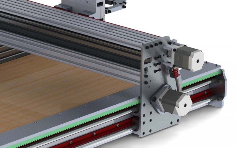

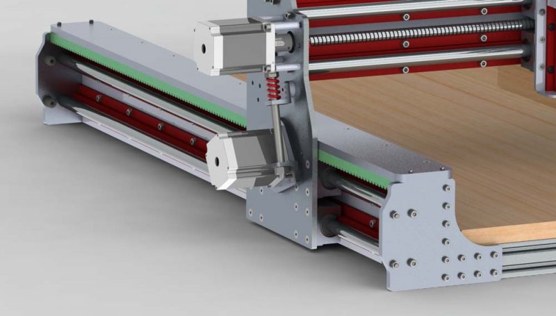

    Thank you for the bearing information. I'm not sure if this idea goes beyond my budget. Quick research shows $300 VS $140. But you are 100% correct $140 is more expensive if does not work. So I'm going to try the Y axis first.
    Gerald I tried putting the rack in between the rails and could not find a solution I was happy with. So played with the idea of bolting a rail to the top to strengthen the Y by creating an additional beam.
    Plus is also helps keep dust & chips from failing on the linear bearings.

    That's spot on Steve. I would definitely use the 1/2 x 1/2 20 pitch 20 pressure rack in that situation, just drill and tap the rack every 6-8 inches and attach to that top plate. I have 6 ft of 20/20 rack here, only reason I didn't use it is because I didn't want to have to make spacers to move the plates out far enough to clear the rack, 1/4 x 1/4 works better in my build... You might want to check out Ricks build on belt reduction drives, i'm working on a set now to use with a R&P setup, would double the resolution and torque of those motors along with offering a stronger shaft and bearings for the pinion gear.

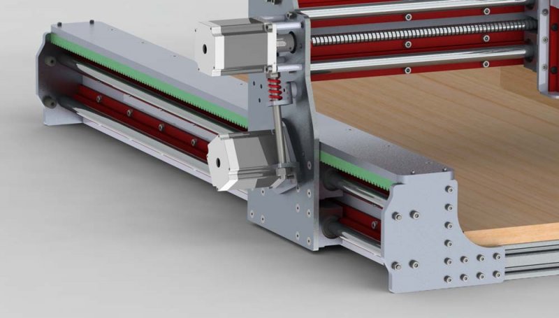

    Next I worked on the main beam design again. I thought if I take the two original 20 * 60 X axis beams and then add two new 20 * 80 extrusions, I could create a very strong box section.
    Basically I have two 20*80 extrusions horizontally, two 20 * 60 extrusion vertically, in addition to the plate than supports the linear bearings.
    My CNCRouterParts nuts arrived Saturday, so I'm going to try this approach first, before going to the expense of ball screws on the X & Y!
    Today produced an accurate 3D CAD model of the anti-backlash nut, so I could work out the correct positions of the X axis & Y brackets.
