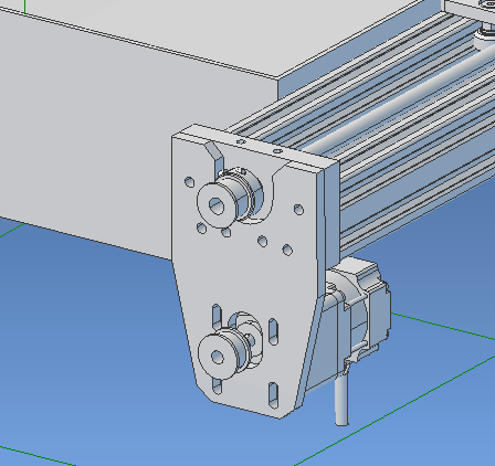

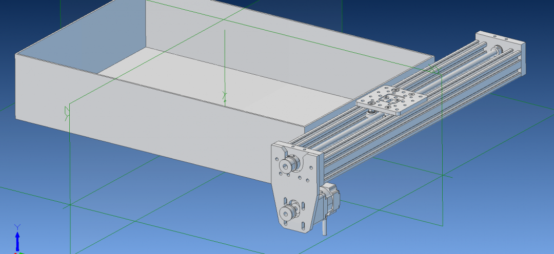

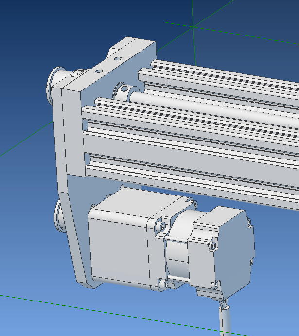

    I took the time to draw up a custom bracket to mount this motor for you and was able to use some stock parts from OpenBuilds for the pulleys and drive belt. Here are the links to that stuff:
    3GT (GT2-3M) 9mm Timing Belt - Closed Loop
    3GT (GT2-3M) Timing Pulley - 20 Tooth - 9mm Belt - 8mm Clamp Bore
    3GT (GT2-3M) Timing Pulley - 20 Tooth - 9mm Belt - .25" Bore
    And here are a few screenshots of the motor mount plate that I drew up. If you like it, I can post a drawing file on here and maybe someone will bite on making this thing for you ;)
    As for your final question about the need for a slip clutch, I actually don't think that is necessary. The drive comes equipped with an Alarm and fault protection, and in the case of an overload, this will trip, requiring either a reset or a reboot to clear the fault. From personal experience with these drives, this protection has been adequate in protecting the motor, and most cases, a well designed machine will hold up beyond the motor fault. So I don't think the clutch is necessary. You'll just maybe want to wire an indicator light the the Alarm output, and then a Reset button to the Input.
    Let me know what you think!

    Thanks so much for the thought that you have given this and for the image that you have posted. As I look at it, two questions come to mind. I see that you have incorporated a belt to transfer power from the motor to the actuator drive shaft. Until I saw your approach, I had assumed a direct attachment of the motor to the actuator shaft via some sort of collar, perhaps even a slip clutch. Would this approach make sense if the motor and shaft were properly aligned by a custom bracket? Also, until I saw your image, I had envisioned a single double-wide v-slot rail used in a horizontal orientation with the motor directly attached to the screw via a bracket at the end of the rail.This approach would make for a fairly light solution, which is a reasonable objective since the actuator will be removed from the tank and set aside when the tank is being used. Agitation of chocolate is needed only when the chocolate tank is not being used. I'm concerned that it will get covered in chocolate if Ieft in place while dipping is taking place.

    I don't have much familiarity with using slip clutches, but from looking real quick, one hurdle I see having to overcome would be the different shaft sizes between the actuator and the motor. You could machine the end of the actuator shaft to match, that would be an adequate solution, just some custom work, that's all.
    So then to comment of the motor mounting as a foldback set (what I showed with a belt) versus inline, I just always have preferred the foldback for a more compact footprint for mounting, and then from the simplicity aspect of the motor mount plate. You could mount the two pieces inline and then couple them as you said, I think it all just comes down to what you want.
    In regards to the actuator design, I just tried to pick something that Openbuilds offered as a kit. These C-beam actuators are a turn-key solution that just need mounted in place. You could put together your own actuator with the pieces that they offer, I was just trying to keep it simple for you. I've personally purchased the 250mm version of this, and it hardly weighs anything by itself. I think it would work for your need to install/remove frequently as well.
