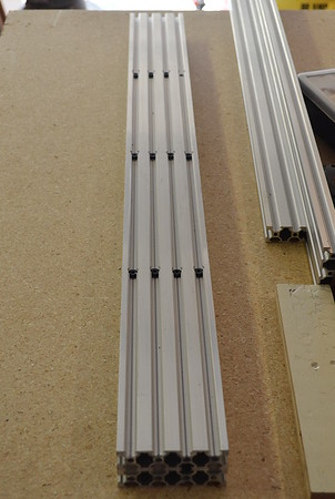

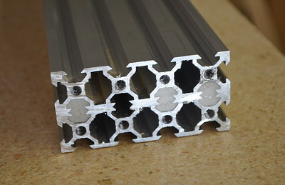

    Thanks. Look what just finished growing up!
    Now. On to the joining ceremony.

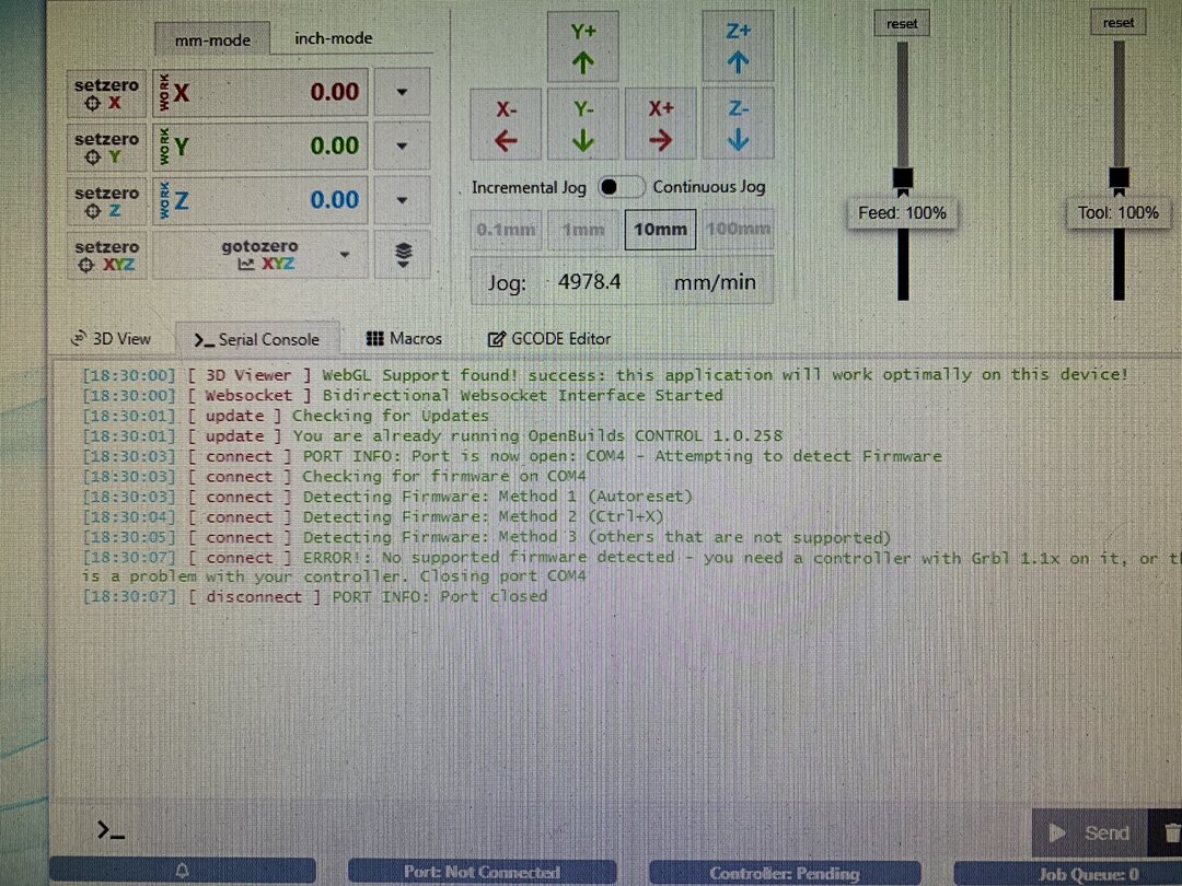

    Ok.. So I am at a loss today.. I shut the system down completely yesterday after finishing up some minor cuts. Today, I turned everything back on, and the Blackbox is not booting correctly. I normally see the USB light on the controller flashing away, but not today. I have double checked all the wiring, and dont see anything out of place.
    This is what I am getting on the system when I try to connect.. One thing that did happen was the Openbuilds Controller updated to the latest version today.. So I wonder if that is the cause..
    I read a thread that had this exact same error, and they thought it was a EPROM corruption in the data for GRBL, and to use the $RST=* to reset the settings to default, but HOW can I do this, if the system will not boot and allow me to connect? Seems that I will be doing some digging tonight, as I wanted to do some cutting tonight..
  7. Peter Van Der Walt
    14,047
    4,123
    Step-by-step: See docs:blackbox:faq-usb-connection-failed [OpenBuilds Documentation]

    While waiting on a replacment BB Brains board, I decided to build an Arduino setup. I will build this as a backup to the BB system, and use external TB6600 Steppers Drivers. I will build this as a direct Plug and Play replacment of the BB, so I will be adding the 3.81mm Connectors to directly plug the wires from everything into the new control box. I will also be trying to increase the DC from 24V to 36V and see if the steppers become more reliable for higher speed moves. Might as well play, while I cant do anything else..

    New brain board installed. Now I’m not getting the steppers to lock in place when not in motion. Time to dig some more but seems the enable is not being set.
    on the old board, when I powered on, you could hear the steppers lock in place. I’ll look in the morning.

    Problem solved. Looks like a GRBL setting got changed when I did the reconfiguration of the new board. Peter Van Der Walt to the rescue!
