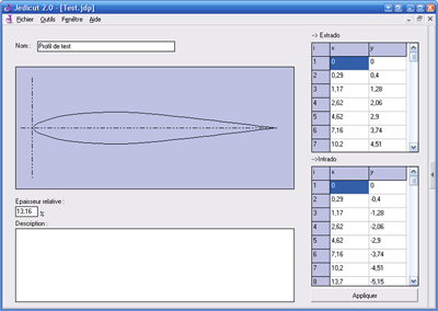

Jedicut for windows 2015-09-24
foam cutting software

    Hello !
    Thanks to my favorite search engine, I discover this awesome site ;)
    My name is Jerome, and I'm the author of Jedicut, a free CNC software for foam cutting (with wire heating).
    I didn't work on Jedicut from many months because I wanted to discover and learn someting new : I recently published my first Android app : Times and events - Android Apps on Google Play
    But here, the main purpose is CNC project and after this Android experience, I'm back on Jedicut. I'm working on a new release with bug corrections and new features.
    Thank you Timothy for your message. It's a good summary to use Arduino as a USB controller with Jedicut. :thumbsup:

    On this new year, Jedicut 2.3.4.1 is available with a new ability : Jedicut can now generate G-Code !
    Jedicut also moved to a new website with a new design, new contents, a new user friendly forum and many more cool things : Jedicut.com :)
