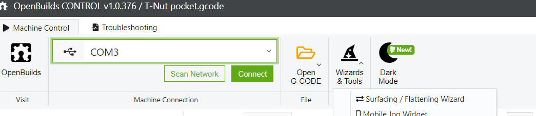

    Not sure if I am allowed to jump in here, but my new Blackbox x32 that I just installed, the x axis are reversed to what the screen says they should be doing. I read above to change it in the GRBL setting on the GRBL settings tab. The problem is that my controller does not have that tab. I installed it last week on a new system. Any help is appreciated

    What control software are you using? If you haven't already done so try Openbuilds Control.

    As I said in my first post, I tried to follow the instructions above, but my software does not have that tab. I might be looking right at it but I don't see it.

    Connect first. You aren't connected to the controller yet in your screenshot. It can't read the settings off a controller its not connected to yet :)

    My apologies, when I plug it in to the controller, the tab appears. Sorry for wasting your time
