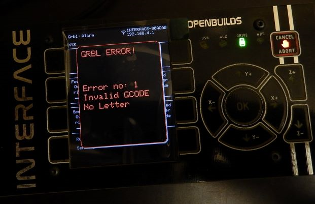

    My Openbuilds milling mackine is located in a place where there is no internet connection. I have prepared both Black Box v 2.7 and Flashdrive as FAT32, but when I try to run a file, the following appears on the screen on the Interface .(I can run the file I use on the PC, but not on the Interface).

  8. Peter Van Der Walt

    Is the Interface Firmware up to date?

  10. Peter Van Der Walt
    14,745
    4,263
    Check the GCODE file for invalid characters (stuff that doesn't fit the GCODE spec like "%" start/end of tape indicators, etc) and remove invalid characters from the file

  13. Peter Van Der Walt
    14,745
    4,263
    Not the name, inside the file...
    Open the file in a text editor, or post the file here if you'd like us to check it
    Things like this:
    Is not Grbl compatible. Raises the error you saw.
    CONTROL we try to filter out the garbage - but Interface doesn't have the resources to preprocess the files for you. What goes into the file should only be valid GCODE and Comments

  15. Peter Van Der Walt
    14,745
    4,263
    Line 1 of your gcode, contains a "%" as does the last line
    "%" is NOT valid gcode, delete that line from the file
  16. Kaj H. Nielsen
    Nov 22, 2020
    19
    Thank you very much,
    the machine is running controlled by the Interface. upload_2021-2-22_20-7-56.png
  17. Peter Van Der Walt
    14,745
    4,263
    Edit the Post Processor and remove the "%" addition section / speak to your CAM developer about removing those ancient artifacts :) to avoid the need to edit the files manually
