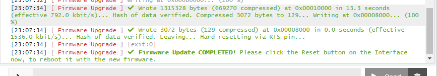

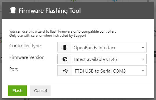

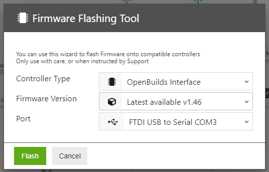

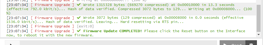

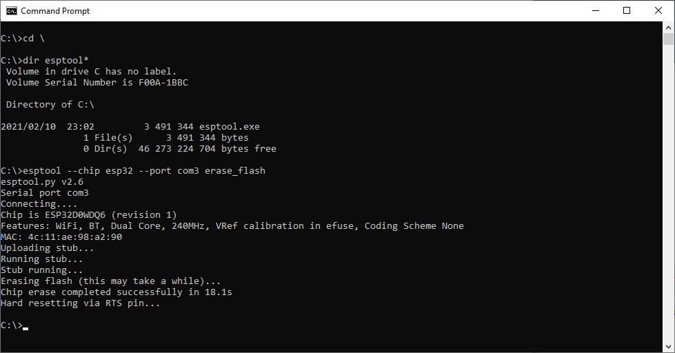

  1. Tyler Skelton
    Feb 16, 2023
    I believe this is my current problem, went through Wi-Fi set up but never could connect after reboot. When I tried to repeat the process, get stuck at 2.3 Configure Wi-Fi using the web interface
    because http://192.168.0.41 is "unreachable"
    Id like to follow the step instructions you have given above but im afraid my computer competence is too low...As in, I dont understand step 1 (Download ESPtool (attached) and extract the zip somewhere you can reach from command prompt)
