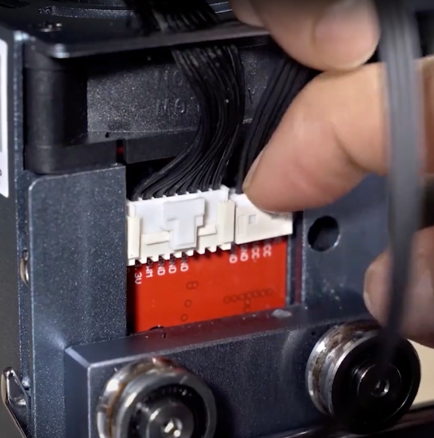

    Here is a clue. I was watching a video on the xTool Infrared laser module.
    The video:
    The reviewer rotated the part around so one could see the back and connector.
    This is a part of the screen shot, let's see what we can make out on it.
    Left to Right (gosh, I wish I had that infinite movie enhance capability):
    • (unsure - two characters)
    • (unsure - three characters, last one a "D")
    • PWM (95% confident)
    • GND (100% confident)
    • VCC (100% confident)
    Just given this, if there is simply PWM for power, it may be possible. And assuming the 20W blue is a similar interface.

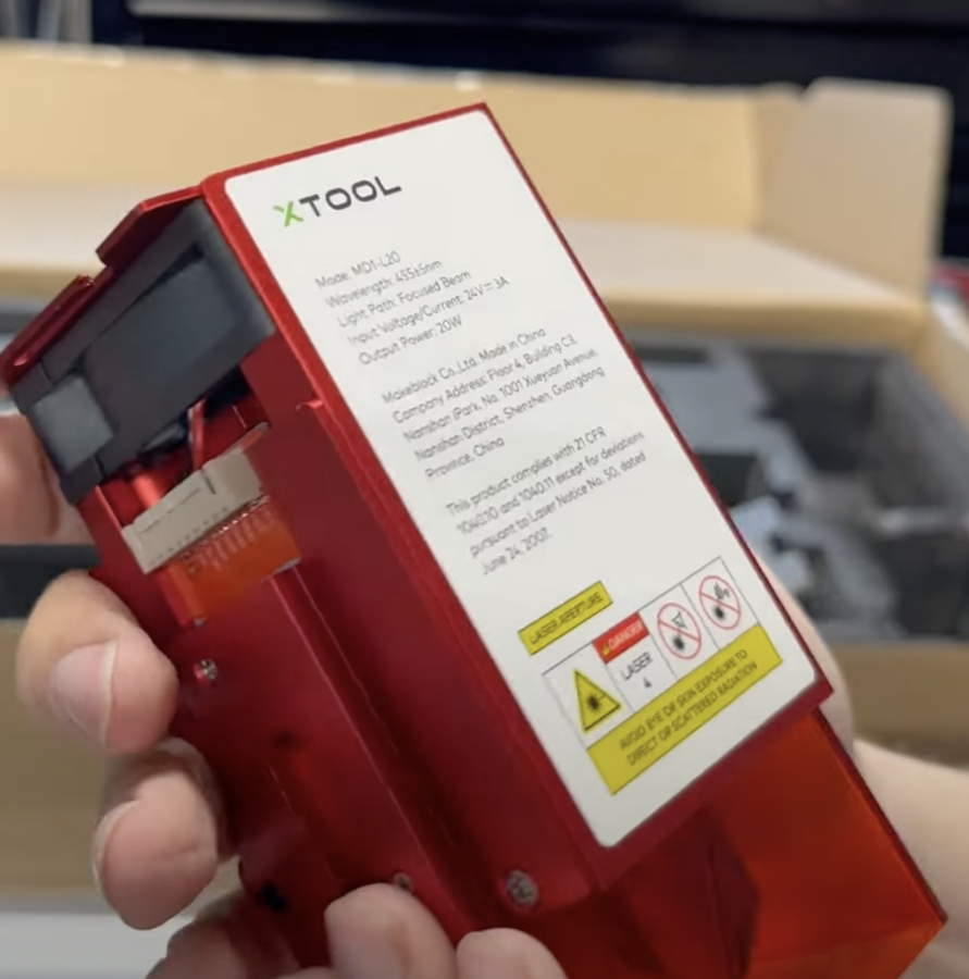

    And a couple more screen shots, this one is of the actual 20W module.
    Two connectors, so different.
    Left connector, 8 conductors, only a few labeled, guessing electronic power and signal (left to right):
    • (Unsure - obscured, may be nothing)
    • 3.3V
    • PWM
    • GND
    • GND
    • GND
    • (blank)
    • (blank)
    Right connector, 4 conductors, guessing laser power. (left to right):
    • GND
    • GND
    • VCC (24V, likely)
    • VCC (24V, likely)
    Screen Shot 2022-09-28 at 1.24.37 PM.png Screen Shot 2022-09-28 at 1.24.31 PM.png
