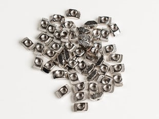

    [​IMG]These are M4 Tee nuts for 20mm OpenBeam. They might come in handy for V-slot as well.

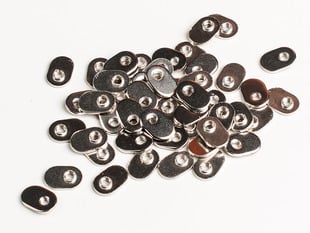

    [​IMG] These are similar to the insert nuts in the store, but M4 instead of M5

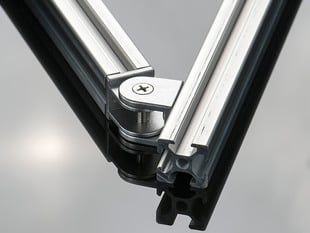

    [​IMG]A plastic hinge that would work on V-Slot. Very useful for doors.

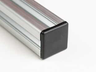

    [​IMG]Plastic end cap that would fit v-slot perfectly. 10 for $5

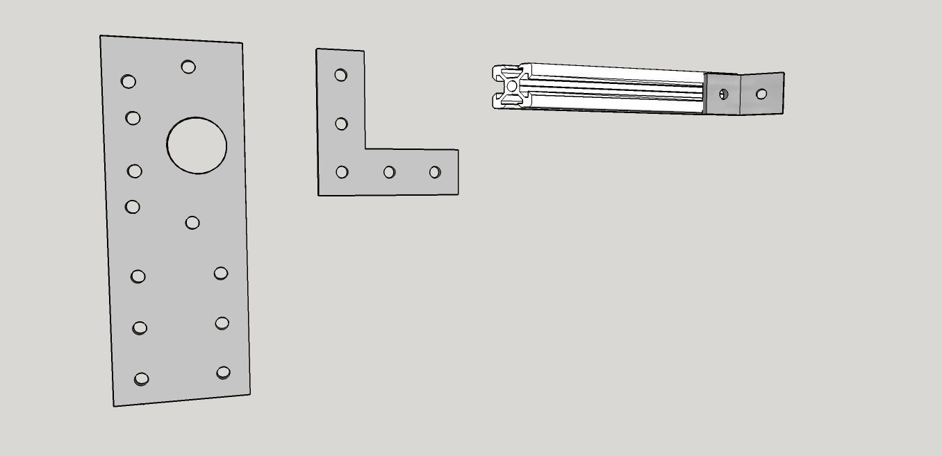

    Mark Carew , here are some more ideas for brackets:
    The first one is a mounting plate for the end of a C-Beam that allows you to mount it on a cross 20x60 for a foot. This could be extended to use a 20x80 as well. The large hole is big enough for clearance for a flex coupling so this can be used on both ends of a c-beam.
    The center one is a simple outside corner bracket that allows you to tie two v-slots together on the 20mm edge. Very handy.
    The one on the right is a 135 degree bent bracket that allows you to tie a piece of v-slot at a 45 degree angle across a corner. Simply miter the ends of the v-slot and use this bracket to attach. This would be very handy for strengthening base and gantry assemblies against racking. Of course, this could be modified into many variations, including 30 and 60 degree types, and inside and outside versions.
    All 3 brackets are made from 1/8" aluminum. Sketchup model is attached.

  11. Mark Carew
    2,750
    2,423
    Great ideas @Metalguru (some may even be in the works ;) ) there are some many possibilities with a modular system like V-Slot that the fun is endless! :thumbsup:
    Many thanks for the suggestions my friend
