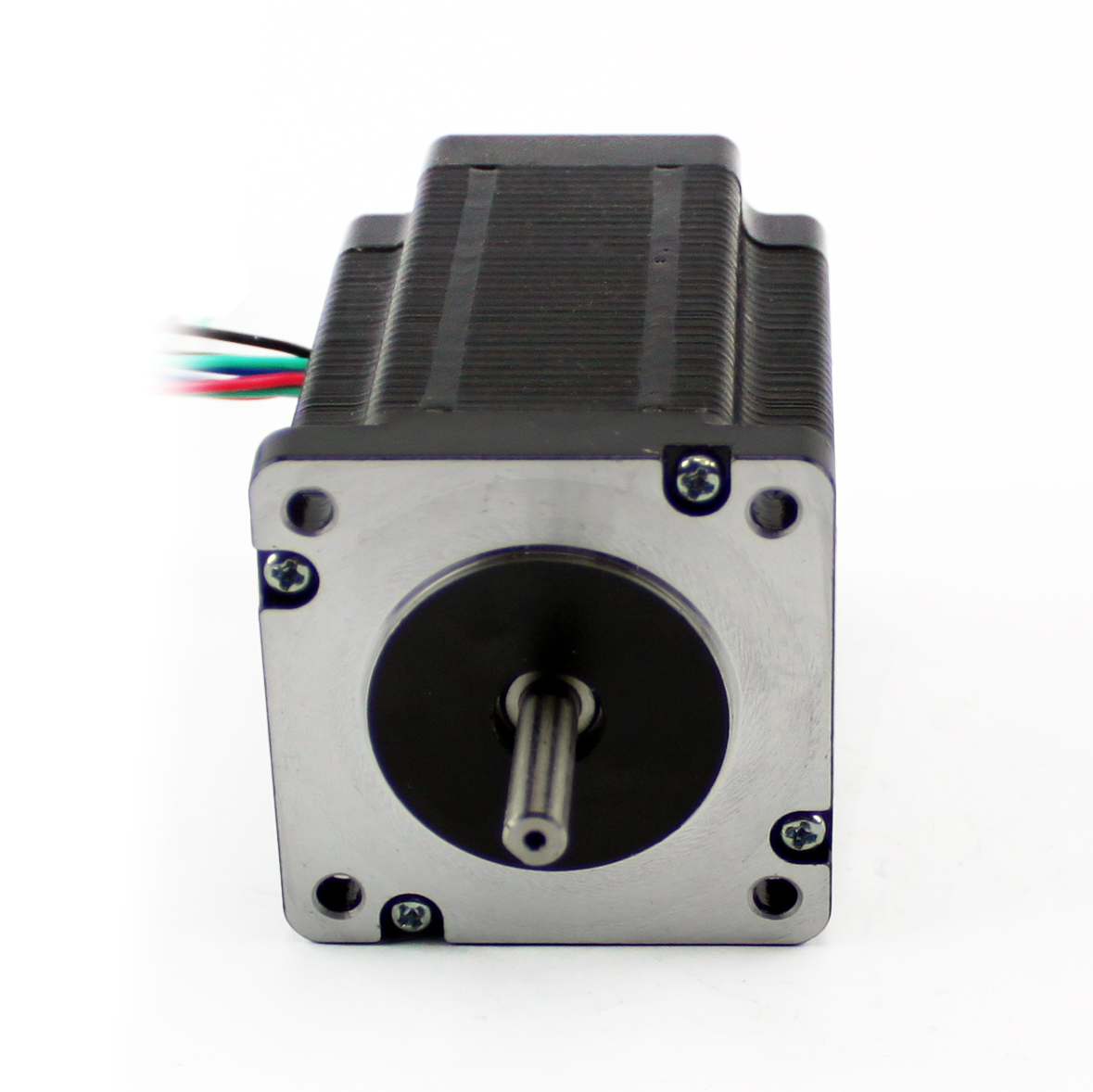

    So I'm looking at a 4 axis kit with hybrid stepper motors (8 wire). I haven't come across many of these in my searches, most kits were bipolar 4 wire. Any issues with these motors? Any down side?
    KL23H286-20-8B Stepper Motor
    This 425oz/in NEMA23 stepper motor is well suited to medium sized motion control projects of all types.
    • 425 oz In. Hybrid Motor
    • 1.8° /200 Steps Per Rev.
    • 2.8 Amps Current Per Phase ( Bipolar Parallel)
    • 8-wire Bi-polar or unipolar, NEMA 23 Frame

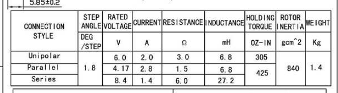

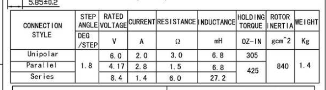

    I bought 4 of this same stepper for my workbee, and although they are running for me, I'm pretty sure I need some tuning for best performance. I wired them as parallel bipolar, and have 36v power supply. the spec sheet for the motor shows this:
    does this mean 2.8 amps is as high as I can set the driver? my kl-5056 drivers have a setting for 2.7a, so I chose that. with the steppers powered and still, they are quite easy to turn by hand if I grab the coupler. I'm pretty sure I should not be able to turn them when powered. the drivers do have a half current setting with very confusing documentation, so I'm not sure what I have set.

    Theres three key values to choosing steppers:
    Current rating (Maximum current draw: make sure you have drivers that can supply at least this much)
    Inductance (Higher inductance needs higher voltages. Our High Torque motors are 4mH, in Parallel wiring these are 6.8mH so would probably do better at 60v. Our 4mH ones have a recommended 24-48v. In Series wiring its a whopping 27.2mH - so more like 100vdc)
    Resistance (Or more importantly calculating coil voltage from resistance and amps if its not on the datasheet). Higher coil voltages need higher stepper driver voltages. You want a lot more voltage than the rated coil voltage so that a modern stepper driver can do its thing (Chopper current control with fast PWM voltage = need mugh higher input voltages for fast rise times to accurately produce the correct output for the motor).
    So basically, the motors you bought are high voltage motors. Getting them to work will be sooo hard, I'd personally just get more suitable motors.
