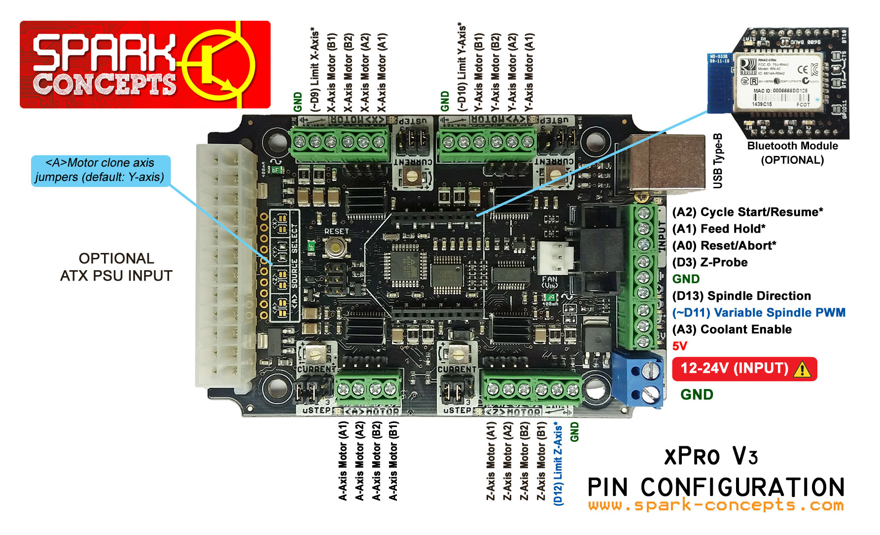

    I have a large 24VDC motor that I took from a small CNC engraver shown at Micro Center - Computers and Electronics. How can I connect this motor as a spindle to the CNC xPro board so that the board can turn it on and off? I looked at the xPro wiki at 2. Connecting CNC xPRO · Spark-Concepts/xPRO Wiki · GitHub but i'm not sure which circuit is best for the motor. I'm confused by the picture at https://raw.githubusercontent.com/Spark-Concepts/xPRO/master/wiki/xProV3(back).jpg because there is a black box and a yellow line below the motor. How can I connect the motor to the board? I'm building a larger CNC engraver using the ACRO System.
    14,571
    4,230
    The XPRO spindle signal is a logic "signal" (5v 10ma) -> use that to PWM a proper DC Speed controller, or mosfet circuit to switch the high motor currents

    But due to my limited electronics knowladge , I would like to ask for a more detailed explanation. On the speed governer there are 3 wires connected to a potentiometer which control the speed. Can these wires be connected on the xpro CNC to control the speed from teh software ?
  12. Gooshpoo
    Gooshpoo Well-Known
    Jul 17, 2017
    52
    29
    It should have a Jumper if you ordered the type i linked. You move the jumper to the other position this should allow for pwm control from the screw terminals. at this pont you should just have to connect to the pwm pin and ground pin. witch is pin D11 and use the GND in the same line of pins dont use the main ground.
