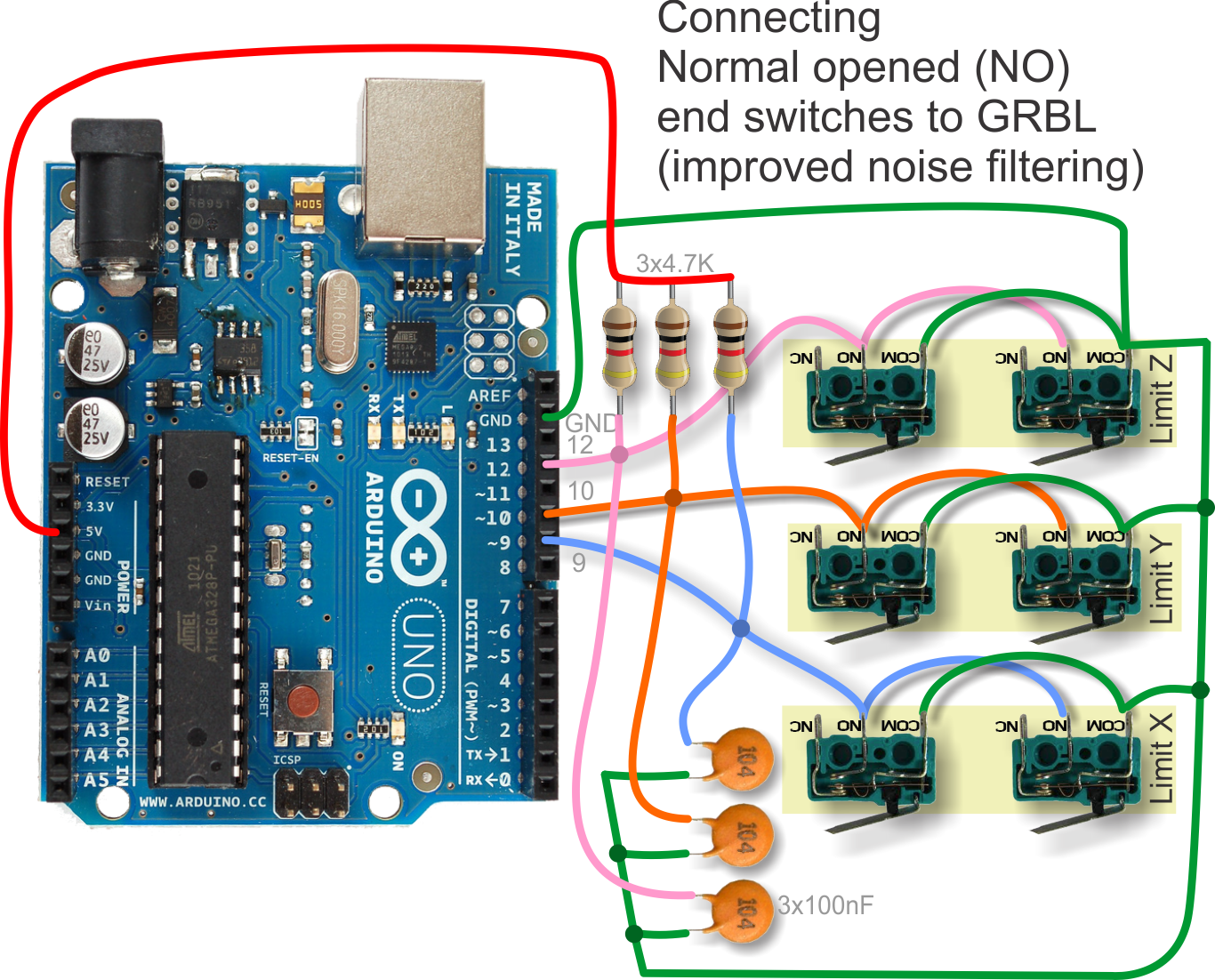

    Built a modified Plate Maker a while back and just upgraded to the BB, All limit switches working. Verified multiple times. When Homing is triggered, The Z axis homes like normal, BUT Y and X headbang against the stops.
    Switches are wired normally open, What's driving me nuts is that Only the X and Y headbang. Z works as it should. If I manually trigger a move into the X and Y limit switches it throws a fault. Never had this problem with my X-Pro and the controller is the only change I have made. Here is my grbl configuration.VER:1.1g.20181112

    Just as a side note, All my endstops are in shielded cable and I also have the noise suppression circuitry.

    When you revisit it shout, its probably something simple yet not immediately obvious. A shame its already torn down, pics of the wiring, switches and how you setup your noise suppression would've been welcome to help check it out.

    Switches are wired as per gnea/grbl,( As they always have, originally built the cnc 3 years ago minus the Arduino of course) with
    End stops where verified 2 ways, Once in the diagnostics (red) and then triggering moves on each axis, each direction via control/jog axis. Each over travel jog moves triggered a fault consistently when the endstop switch was hit on both direction, on all axis. The really odd part is that the Homing sequence works correctly on the Z axis, only the X and Y axis homing is not sensed. The controller was run with the following firmware installed.

    Multimeter is the less interesting one: We want to be sure GRBL sees the signal change (whether wired correctly or not) - the fact that Troubleshooting DOES show it detecting correctly means the BlackBox hardware is 100% and means we need to look at Grbl settings...
    BlackBox has onboard Noise filtering (RC filter on all endstop and probe inputs) : Connect your switches as shown in docs.openbuilds.com (without extra circuitry) - two sets of RC filtering may be too slow a rise time...

    Xpro configured for 1/8, I'll remove the filtering and drop the homing speed. I'll try that as soon as I swap the BB back in and let you know whats happening.
  11. willy44004
    May 18, 2017
    OK, re-installed the controller, removed the de-bounce first and re-tried home. It still head banged. Changed $25 to 250, homing worked, bumped it up to 500, it worked. I arrived at the $25=1000 by testing what the max was with the Xpro. Maybe the internal de-bounce circuitry is too conservative. I was running the CNC almost 24 hours a day for the first year I built it, so the slow homing time added up. I was milling parts that too 1 1/2 hours so I was homing a lot.
