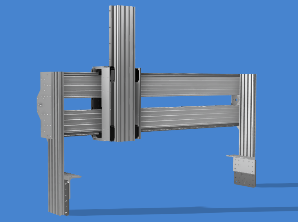

    Are you referring to a Z-axis configuration similar to the sketch about 3 posts up? If so, you have all the parts necessary.
  2. ClaudeJER
    ClaudeJER Well-Known
    Oct 2, 2018
    39
    27
    I'll have another look at it using the Workbee Z setup as guide.
    The xl plates configuration is slightly different with wheels mounted on the front and back in respect to the X axis.
    Do you have a machine setup in that way?
    I can't see how I can get the Z beam mounted the same way as the workbee with the hardware I have.
    I think I am missing an xl plate or
    I build the X axis carriage with the two wheels between the xl plates and use extra long screws and eccentric adjusters to have four wheels in the front to mount the Z beam.
    In any of these option, I don't think I have the required parts!

    Rick 2.0,
    Before I take my machine apart just to have a look,
    Using the LEAD xl plates, is it possible to have four wheels mounted in the front of the X axis with the required eccentric adjusters to have the Z beam free to move up and down
    instead of using an extra xl plate mounted back to back to the X axis?

    Can’t offer a really good explanation right now as I’m at work working on my phone but the only reason for the plate on the backside of the Z-axis is to access the drive screw. In the sketch above the upper rail only has a plate on the front side which is set back to back with another XL plate which the Z-axis rides in. Note, it is best if the lower rail is the drive rail in this system. The upper plate has less force on it so it doesn’t matter if it has only 4 wheels and no back plate.

    I think I just answered my own question about four extra wheels mounted in front of the X axis carriage.
    I don't think it is possible for two axis to share the same screws for both the X and Z axis eccentric adjustment, the position at which both axis adjustment would meet and be happy would be so small because they share the same screws.
    I don't think there is any other way of accomplishing this without the addition of one more xl plate and associated wheels and eccentric.

    It can be done with a minimum of 5 plates which should be exactly how many you have.

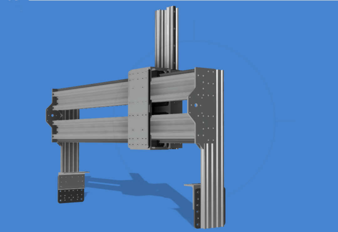

  9. Rick 2.0
    2,862
    1,528
    5 plates as shown:
    And with the Z-axis plates turned 90 degrees to the X-axis plates they connect easily with screws through open holes into threaded holes. The X-axis lead screw nut will be attached to the bottom plate in the rear and the Z-axis lead screw nut can be attached to either of the front plates.

    I'll do that tonight but somehow, I vaguely remember thinking of mounting it this way but didn't have the required parts.
    Carefully looking at your drawing above, I just noticed that the top carriage has been reduced to one plate from two and that's where the needed extra plate comes from.
    I will follow up with pictures in a while.

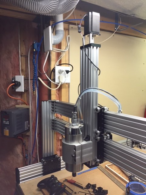

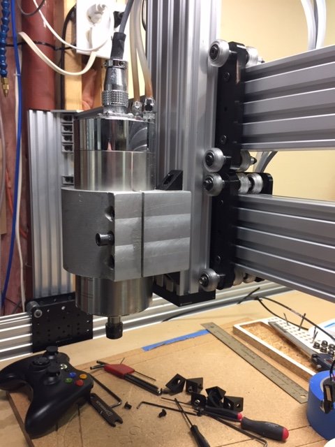

  11. ClaudeJER
    Oct 2, 2018
    39
    27
    Got it done and it is much better this way.

  12. plasma
    plasma New
    Jul 30, 2015
    Custom upgraded lead CNC.

  14. Batcrave
    Batcrave Journeyman
    Apr 20, 2018
    361
    165
    Is that one of the square Chinese air-cooled spindles I see there?
    How's it working out? They looked great for mountability, but I was too taken with the idea of a water-cooled model (which, granted, has worked out lovely, but I still find myself staring wistfully at the square ones from time to time).
    Spindle aside, those are some impressive mods. What all else did you do? It looks like you doubled up the C-beams on the sides & ran linear rails instead of the wheels, a new bed, and are those ballscrews? I can't tell what you used for those brown endplates holding the C-beams together, though.
    Also, what's that keyboard? I've been dying for something better to use as a controller, ever since giving up Mach 3 and the fantastic joypad plugin for a PS3 controller.
    One way or another, that's one impressive machine.

  16. plasma
    plasma New
    Jul 30, 2015
    Thanks Batcrave.
    All beams were doubled down for rigidity. Lead screws were upgraded to 12mm on both x and y axis. So were the steppers. They were upgraded to Nema 34 closed loop 8.5N.
    All the plates I milled on the lead CNC before the upgrade from 7000 aluminum for extra rigidity and then painted them metallic bronze.
    The motor is great. I have used it for about a year right now. It’s a workhorse. No issues. And very easy to trim in my configuration.
    The controller I use is Arduino uno connected to a intel Nuk running Linux.
    The keyboard is used in conjunction with Jason CNC to manually control the movement of the axis.

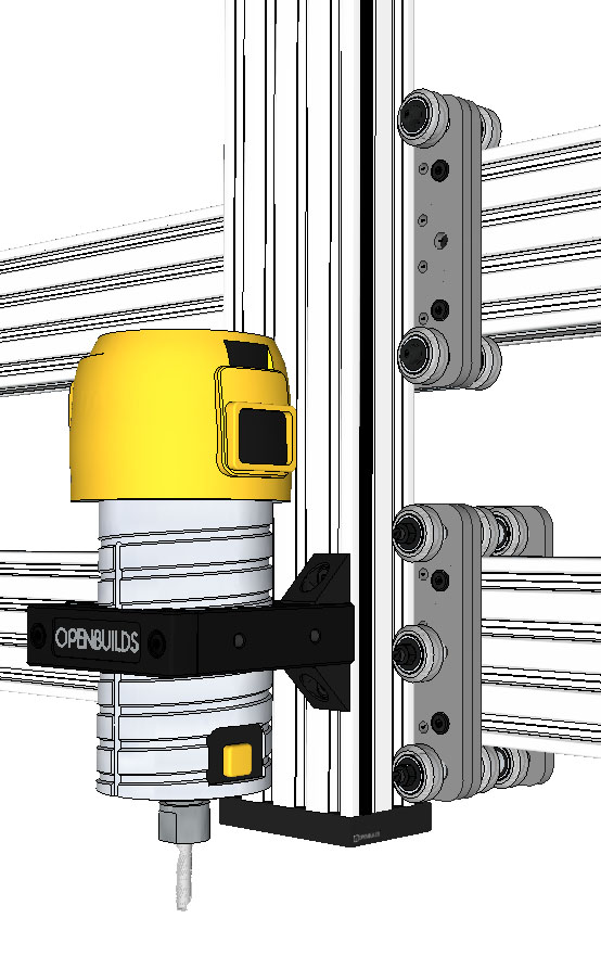

  19. darrepac
    darrepac New
    Feb 28, 2017
    54
    Hi Rick
    Any reason why this sketch (putting the router attached directly to the Z beam and make the whole Z beam move up and down) is not the default mounting option for the high Z mod?
    I do not see the benefit of the default mounting...
    thanks

    Go back to the photo of where Mark is cutting the Hans Solo in Carbomite with a 4” bit in 4” foam. He only needs a little over 4” clear beneath the Z-axis beam to pull this off. With the router affixed to the axis beam and a 4” bit sticking down the axis beam has to start at 8” clear. While it makes no difference with foam keeping the X-axis as low as possible and the Z-axis projecting as little as possible makes a big difference when cutting hard materials. Jacking up the X-axis and reaching back down with the Z-axis only reduces the stiffness of the machine which reduces the quality of the cuts in hard materials. Truly a personal choice but I tend to stick with the fixed beam/moving router/low X-axis in my designs to keep the system as rigid as possible. Never know when you might be inclined to cut aluminum.

    A subsidiary of the Hutt Farms Group responsible for their eponymously named competitor to Vegemite and Marmite, the Carbomite Company fell on hard times after Imperial health inspectors discovered traces of freelance Dutch import/export contractor Hans Solo in a palette bound for Tatooine onboard a transport belonging to Fett Trucking, Inc.
    I've been puzzling over this post of yours for a couple days now, Rick (err, the non-StarWarsy parts of it, mostly), and I was hoping you could clear up whatever I'm misunderstanding. The stock build may make perfect sense if you always cut 4" thick workpieces with 4" bits, but if you're ever going to use that same machine for shallower workpieces (say, a plate of some of that aluminum you mentioned) would it really be better to reach way down from the bottom of the fixed beam with a skinny little extended-reach bit (as the design seems to require) than to run the whole beam down and use a stubby bit?
    The stock configuration seems like it would be especially problematic when using 1/8" shank bits (I can get little 1/8" 10-90° engraving bits by the fistful, for example - and need them by the fistful due to the fragile points - but finding them with a 4" long 1/4" shank sounds a little more challenging and a lot more expensive.
    So am I just misunderstanding how one configuration or the other works here? Or are there some of those fancy mecheng numbers involved that always sail over my head?

  22. Rick 2.0
    2,862
    1,528
    Absolutely correct. And yes, otherwise it makes no sense. But then again...
    It really comes down to how you use your machine as there are decent arguments both ways. The lower you keep the X-axis the stiffer the machine and the stiffer the machine the better the cut in hard materials. If you aren't intending to cut metals though the fixed axis beam makes no sense. If you're looking to make 2" deep cuts into wood that is 6" thick by all means go with the moving axis beam.
    Of course not. Take the work to the bit, not the bit to the work. Build a 2" to 3" thick working platform for when you're cutting aluminum plate. Router projection will easily reach the material even with a stubby bit.
    Again, it really comes down to how you plan to use the machine. So to say which should be the default mode, that would imply that there is a default type of project that the system should be used on.

  26. ClaudeJER
    Oct 2, 2018
    39
    27
    Hi Troy,
    My spoil board is a single layer .750" MFD.
    I found myself in many situations pre High Z mod where I needed to release the spindle motor clamp and lift the spindle to get the clearance I needed.
    The High Z mod is a good way to get more overhaul rigidity especially with the heavier 1500 w VFD but I found that the original Z axis configuration is not really convenient as you still have to move the spindle clamp to get high clearance then release the clamp again for other low height operations.
    The new configuration is the best way to maximize the potential of this modification.
    I hope this helps.

  28. ClaudeJER
    Oct 2, 2018
    39
    27
    I like the water cooled VFD because it is powerful, quiet and there is no cooling air to pickup the dust and blow it around.
    I have done some pieces with close to 100,000 lines of code with the machine going for well over an hour, I don't think a router would survive that abuse, it's not built for this kind of duty cycle, I never tried it.
    I installed a 1500W chinese VFD I bought on ebay with the ER11 collet kit and the 80mm mounting bracket which I easily adapted to mount on the Z rail with a bit of milling.
    The first thing I did to the motor is get in the end cap to install a ground wire which I ran into the spindle using the spare pin in the screw-on connector, the setup does not provide for one and I am not comfortable with running this 220V/3 phase VFD with water cooling jacket without a proper ground.
    I would strongly suggest getting help from an electrician or someone who has a very good understanding of the electrical aspect of this installation before you attempt to do it yourself unless you know and fully understand what you are dealing with, this system can kill you very quickly if you mess up!

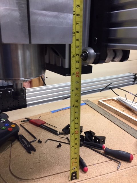

    May I ask what the overall height is please? I would like to build an enclosure for my 1515 with a view to modify the z axis at a later time. Cheers
