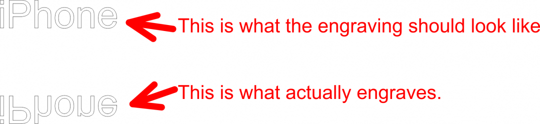

    Hello everyone,
    I am new to the forum as well as GRBL so I would like to say hello to everyone. I have searched around the web and as well as this forum and still have not found a solution to my issue. So I thought I would try and ask you knowledgable folks to see if anyone can shed some light on my problem. I apologize if this is not the proper place for this question. I do have experience with more industrial CNC machines (9+ years running a couple AXYZ machines) and I own a small desktop 3d printer but I recently bought a small desktop cnc and for the most part everything is good (other than I received 2 different pitched lead screws so had to model and 3d print a new part so I could use threaded rod until the new lead screw comes).
    The issue I am having is that after I set up my machine and tried to jog Y axis with the ^ key in grblControl the machine actually moves towards the front instead of the back. Same with my Z axis I press down and it goes up. So I changed $3=6 which inverts the direction on the Y and Z axis according to the grbl help. So now they are working with the keys in the right direction, yay! Then I go to run a quick test file but the engraving is mirrored vertically. I have attached a photo to show what I am talking about. I have tried changing the step port invert mask as well but that didn't seem to do anything. Any help is greatly appreciated. Thank you

    Maybe try setting the settings back the way they originally were and change the wiring to the motors so they go the direction you want them to go. You should only have to change one pair of wires per motor that is going the wrong direction.

    Thank you I was just hoping not to have to switch the wires around in the connector. I just don't understand why only the y axis isn't working properly when inverted in the grbl settings but the z axis works properly when inverted (jogging the machine as well as running a file). I think for now I will just have to leave the y axis without inverting so my files run properly and remember that it is opposite when jogging.

    You did reboot the Arduino after you changed $6, right?

    Guys i have the same problem here , All the letters are mirrored upside down.[​IMG]

    1) OpenBuilds Control > Grbl Settings > Invert Direction > Invert Y
    2) Save
    3) Reset
