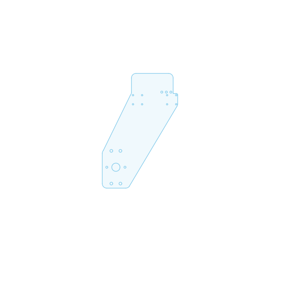

    Can someone who is fluent in Fusion 360 help me out with a drawing. First of all I don't use Fusion 360, I tried learning it in the past and just never continued. I have a drawing of the side rails of my cnc but I would like it to be 2" taller than what it is right now. Can someone modify the drawing for me if I upload it?

    Is the dimension labelled in the pic what you want increased by 2"?
  7. Salamander
    Dec 13, 2021
    48
    15
    From bottom to top. The entire plate so that it can be 2" taller so it wont hit my vice when I have it on the table.
  8. Salamander
    Dec 13, 2021
    48
    15
    I think the entire plate is now 201mm and i want it to be 251 which is 2" longer.
  9. Alex Chambers
    2,700
    1,327
    So I'm assuming the pic shows it upside down, the holes near the bottom want to stay where they are in relation to the bottom of the plate, the holes at the top (presumably include motor mount and hole for leadscrew) stay in the same relationship to the top of the plate but move 2" further away from the bottom of the plate?
  10. Salamander
    Dec 13, 2021
    48
    15
    Exactly Alex, I couldn't explain it any better.
  11. Alex Chambers
    2,700
    1,327
    Like this?
    If so I have modified both files, but I only have the personal use license and can't export dxf files - Fusion files attached so you can get someone with the full license to export the dxf's for you.

    Alex, I figured out what it was. I was able to login to my fusion trial account and exported the file to sketchup, problem is it exports to a really old version and it seems the file is messed up so it doesn't show anything. I exported to dxf without issues and the file opened in Estlcam.
    Thanks again for your help.
