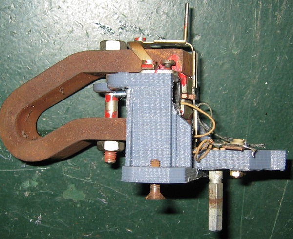

    Hi,
    Here is my first old radio printing :
    this is a loud-speaker motor, from an old german receiver.
    The old mechanical part was maid in Zamac, and this alloy has desease : it falls in powder !
    So, I made one replic in PLA. It's strong enough and LS is working, now.
    You can read (in french, sorry) how I proceed here :
    http://www.cfp-radio.com/realisations/rea93/moteur-skagen.html

    Excellent work Pierre :thumbsup:
