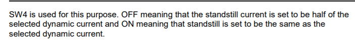

    That would not be too good for the machine as ever time the drives disable there is a chance the position moves.. The drive does have a reduced power mode as set by switch #4
    Cooling fans are a good idea, the setting for current will make a difference in the heat as well.

    Thank you Gary, I will switch #4 to half current and check into some fans. But I want to get it right. I should never wire the ENable connector as it only disables the steppers?
