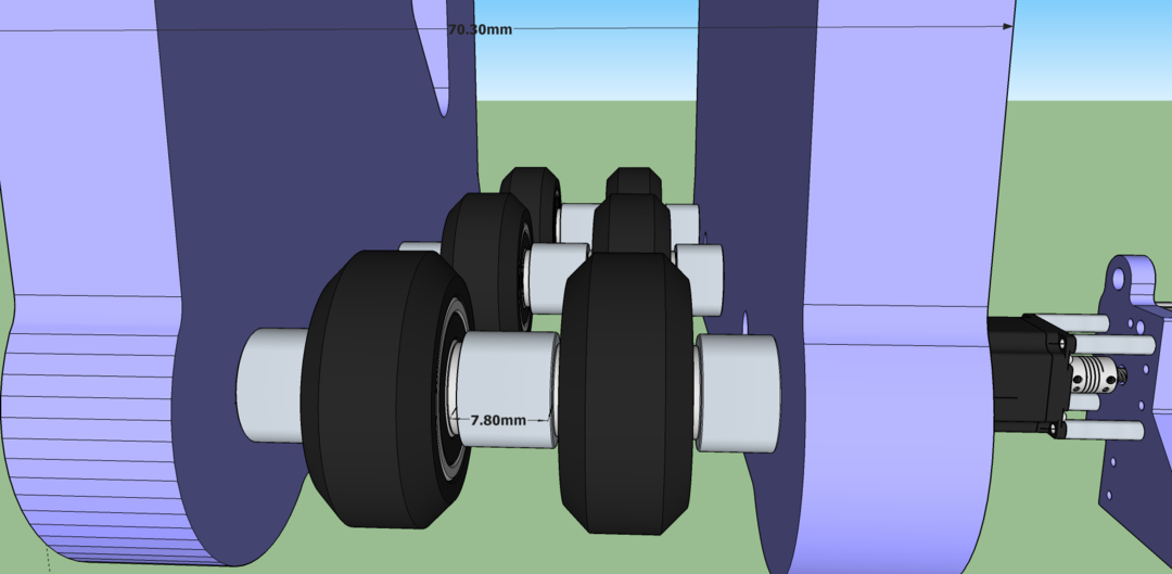

    Hope your aluminum plates are working out, what thickness are you using? A quick question, I know you had problems with the double wheel spacing so they would both lay in the v-grooves nicely, I calculated it using SketchUp and came up with 7.80mm plus a 1mm precision shim on each side. Does this correspond to what you ended up with? I have longer lengths of aluminum spacer and I can cut and sand them down to whatever I need using an edge sander. I also had trouble finding 5x75mm bolts for this application, ended up getting lengths of 5mm threaded rod and cutting them down. Where did you find long enough bolts for your build? Again, thanks for the advice! Double wheel spacer.png

    Hi Charlie, I'm going with 8mm plates in aluminium. But for the acelta machine which had 12mm plates I think I used 70 or 75mm long machine screws. I ended up using stainless steel flanges machine screws but I really wish I bought high tensile ones for everything. I bought mine from Ebay - I know ooznest sell 65mm low profile ones here in the UK. The spacing for the centre of the gantry wheels is around 9mm but in the end I realised the problems the v wheels create can only be sorted by designing the pivoting plates and tramming mechanisms. Good luck with the build! :)
