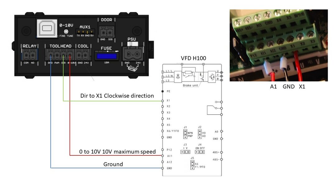

    (NOTE: This applies to the BlackBox X4 only)
    And finally I got my H100 VFD 220V with 1.5Kw Spindel 2 poles air cooled connected to the BlackBox. Follow the instruction above. and the how to configure the H100 VFD below. I have testet it with my CNC and openbuild controle. Dont forget to calibrate the 0 to 10V
    H100 VFD 220V with 1.5Kw Spindel 2 SETUP
    F000 = 0 (Disable parameter lock)
    F001 = 1 (External signal)
    F002 = 1 (Analog input A1)
    F005 = 400 (Frequency limit)
    F004 = 400 (Spindle rated Frequency)
    F003 = 400 (Frequency at 10V will be 400hz)
    F014 = 10 (Acceleration time)
    F015 = 10 (De acceleration time)
    F143 = 02 (number of poles the 1.5kw spindle has)
    F144 = 24.00 (Maximum rotation/minuet)

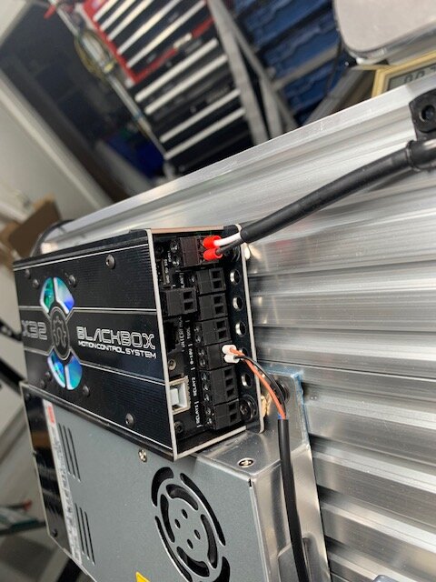

    Awesome. A slight modification if you have the X32 is run the enable line from the tool connector to X1 and the 0-10 from the 0-10V connector.

    Just make very sure that the X1 does NOT have a 24v pullup (Some VFDs do) or it may damage the BlackBox.

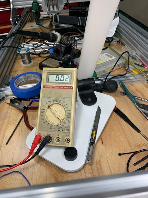

  10. Ksheren
    Ksheren New
    Sep 11, 2017
    13
    I have attempted to adjust the voltage. Is the above link says to do and the most I can get is.03 volts dc.
    Very frustrated any help would be appreciated.
    Thanks in advance,
  11. Peter Van Der Walt
    14,042
    4,123
    Any earlier wiring different from the picture you sent? History along the way could have an impact
