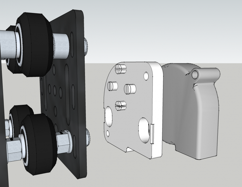

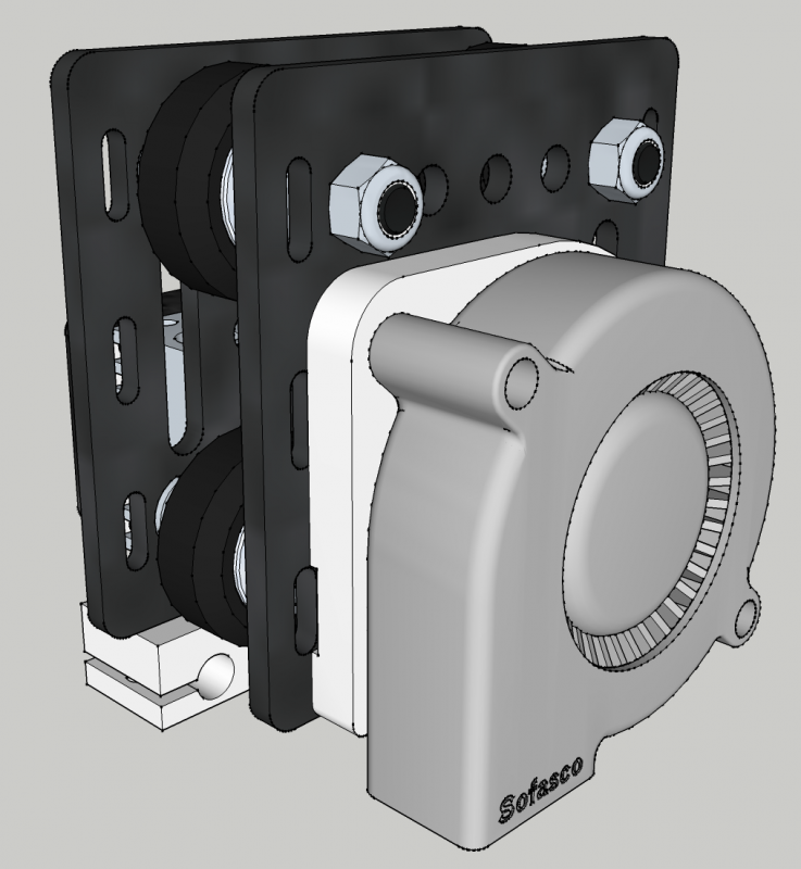

    Designed an adapter part to mount a 5015S blower fan to the back of the hot end carriage.
    The fan gets screwed to the plastic part (the white piece) with 20mm M4 screws, or some other coarse-thread screw that's about 4mm in diameter.
    And then the adapter plate just snaps on to the back of the gantry plate with press-fit snap pegs.
    I'm still working on an air duct to direct the air from the cooling fan to just under the extruders.

  3. Tweakie

    I certainly like the idea of the snap-fit pegs - excellent solution to mounting the blower. :thumbsup:

    Thanks - the pegs printed nicely in ABS, flexible enough to be squeezed without snapping.
    Don't have a plate yet to test the fit, but I'm sure it will be fine.
    The widest part of the pegs comes out to 5.2 mm.

    Also love the snap-fit solution. I'd be happy to test it out on my plate - could you upload the skp or stl? I have a different fan/duct mount in mind for mine (integrated w/hot end) as I plan to use the other side for additional hot ends (for future quad printing or a direct drive setup). Snap pegs might work for a quick release on my hot-end mount but I would like to try it out first.
