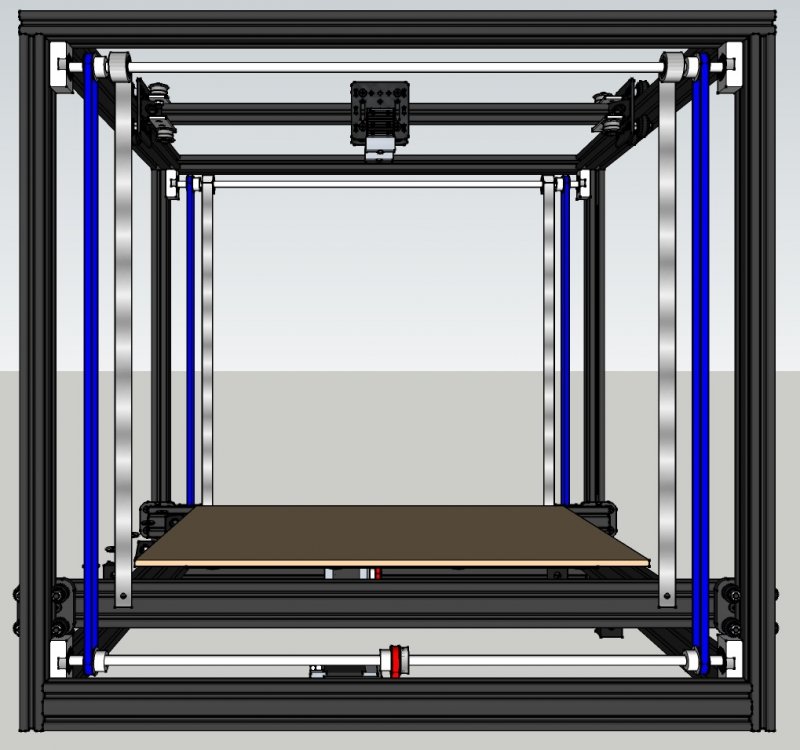

    The plan is to drive only the lower rod with 20T GT2 pulleys and a short closed loop belt.
    Rostocks use a non stretch woven fishing line and winding pulleys, so I may try something similar.

    Here's what I have so far, based on 6mm wide GT2 belt, 8mm drill rod, 20T pulleys, and bog-standard 608 bearings.
    Lower rod is driven by closed-loop belt to the stepper (it's a heavy duty one), and the blue belts raise/lower the Z rail.
    Although I do like the idea of the constant-force springs - one at each end of the Z rail would offset the weight, making the belts only have to pull the rail down instead of holding it up.

    I like it! Properly balanced, constant force springs would also reduce Z axis drop forces in the event of loss of power to the steppers. In fact it may still allow the bed to be suspended in absence of power to the steppers. Regardless it would certainly prevent the build plate from slamming to the bottom during such an event.
    Depending on your pulley selection and stepping resolution, you should be able to obtain ~10 micron resolution with this setup as well. I think this is the max my lead screws can do so I don't think you aren't giving up anything going this route - just adding a slight amount of cost/complexity but not too much. Looking forward to seeing it's performance!
    #98 TomH, Apr 24, 2015
  9. Giuliano M
    Giuliano M Well-Known
    Apr 3, 2014
    193
    39
    1.8 degree stepper with 1/16 stepping, and a 16 tooth pulley would get me 10 micron.
    If I put a 32T pulley on the 8mm driving shaft, and a 16T pulley on the stepper motor, I could theoretically get a 5 micron capability.
    It would also let me do 1/8 stepping for 10 micron, for more accurate steps and holding power.

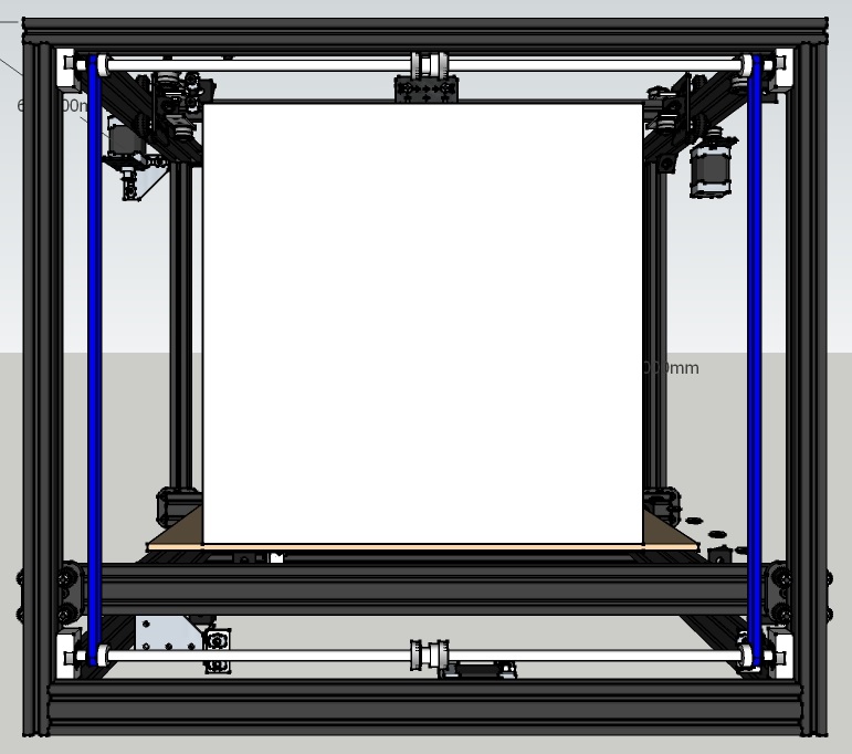

    I think I'll go forward with the GT2 belt arrangement - as nice as the PosiDrive system is, it's not metric.
    Belt-driven 16T/32T will give a nice 2:1 reduction, and an even amount of steps for 10 micron.
    Here's the view from the inside of the frame, with the driving belt (red) and the vertical motion belt (blue).
    The red belt will be a GT2 6mm wide closed loop belt, 122-124 teeth long.
    Conveniently, RobotDigg has them for cheap: http://www.robotdigg.com/product/203/122mm,-124mm-OR-132mm-long-2GT-6-endless-belt
    The blue belt will just be an open length of GT2 belt.
    I'll probably work in some kind of belt tensioner system for the blue belts as well.
    The stepper motor mount will be just a piece of 2" 6063 aluminum angle - I'll have to cut and drill, but that shouldn't be difficult.

    I did some expected weight calculations - I weighed a 500mm piece of 20x40, and it came out to be just about 0.75 grams per linear millimeter.
    So I took the measurements of the four bars that would form the main frame of the Z-plate, and they totaled about 4 pounds.
    If I add on a 1/4" thick, 16x20" MIC6 cast aluminum plate on top of that as a heat spreader, it adds another 8 pounds.
    So, I would have to counterbalance for a pretty heavy 12 pounds or so, for a distance of about 24" or so.
    I think these 2.63 pound springs would do, if I had four of them:
    Stainless Steel Constant-Force Spring, 4000 Cycle Life, .008" Thick, 30.0" Long, .5" Wide: #9293K52
    They wouldn't offset all of the weight, but it would take a good 10 pounds or so off.
    I'm thinking I could mount them on top of the frame, on ball bearings.

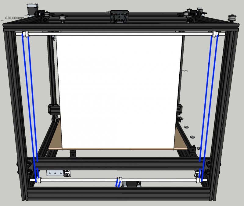

    Front view of the assembly, with the setup mirrored on the back side of the frame.
    I'll probably have to design some kind of a printed part to support the bearing in the center of the lower rods, next to the red belt.
    The red belt will need to be tensioned, and the rod needs a support to resist the tensioning force.
    With the vertical V-Slot beams lengthened to 600mm, there's just over 430mm of vertical build space.

    I suspect that for greatest longevity it would be best for the plate the be left at the top (almost fully coiled springs) - not something it will default to unpowered without mechanical assistance unless your net force is positive (which if you did design it for, would also provide an intrinsic indication of weakened springs).
  23. TomH
    TomH Well-Known
    Mar 10, 2015
    108
    Vertical movement of your lower rod will provide tensioning adjustment for your red belt. And if you move your Z stepper and drive pulley closer to one end you would likely not need additional shaft support.
