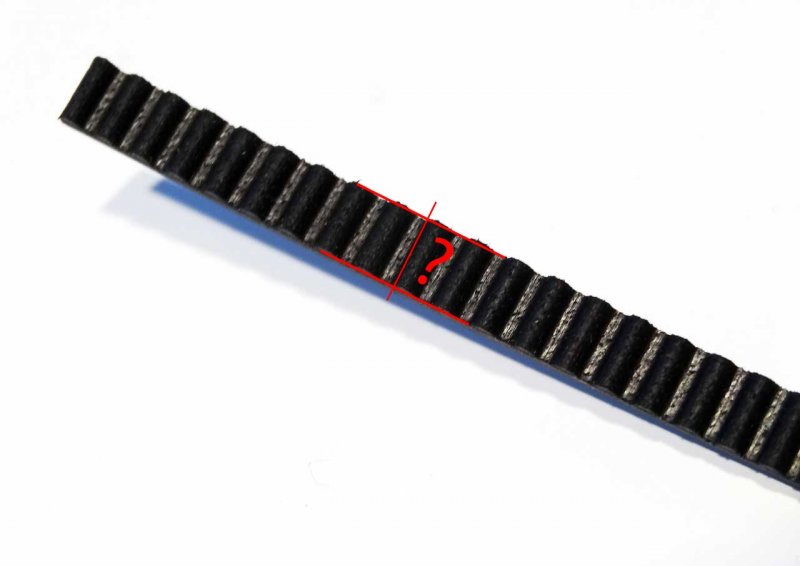

    Hi, sorry, I want to know how high the belt. See Image. And if I could use with this and this, like:
    I Tri to motorize My Slider

  6. GrayUK
    I thought he meant the height of the peaks and troughs! :banghead:
    Not the width.
    Gray
  7. John Meikrantz
    John Meikrantz Well-Known
    Nov 2, 2014
    169
    56
    Here are specs on belts from sdp-si.com. I believe the belts from Openbuilds are GT2 3mm pitch - figure 19h.
