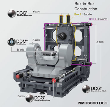

    Mori/Seiki have interesting concepts. Here is one of their 5 axis machine :
    The tool end only moves in two axis, X and Y. The piece being worked on is moved for Z as well as A and B axis. It makes for a big machine for a relatively small working volume, no ?
    One could make a 3 axis version for 2.5D work with not much depth being needed... Would need to hold the work piece, like a sign, firmly and move it forward and back the inch or so needed for 2.5D applications. If one can get away using a flat motor (as used in larger multicopters) for a spindle, I bet the machine could be squeezed in a space about 12" deep, if not less. :rolleyes: The work piece, or 'floating' vertical table holding it, would also act as a shield in case something goes wrong.
    Makes me wish I was already retired, with money to spare to play with these thoughts ...
