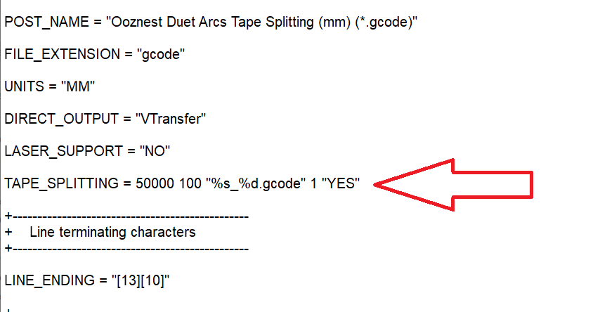

  19. Alex Chambers
    2,760
    1,352
    Much easier in Vectric - see pic.
    You have to change the number of lines/file by editing the post processor though.
