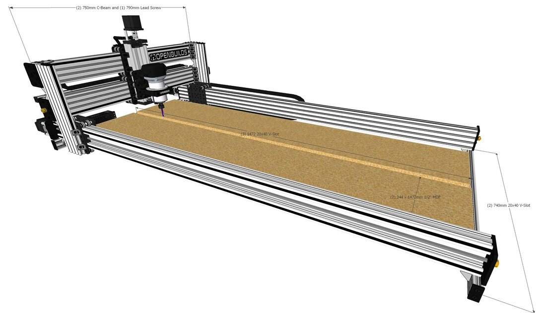

    Hello all!
    Looks like I'm finally ready to move forward with my first CNC build!! Just not sure where or what to start with tho.. Looking at the LEAD 1515, but I do not think I have the space for the large footprint at the moment. Would you guys suggest starting with the 1010 and expanding in the future, or starting with the 1515 and cutting the axes down? A 2' x 4' work area will be about all the space I can afford for the time being (understood the machine foot print will be slightly larger..) but if all goes well I would like to utilize the full work space of the 1515 at some point in the future.. Would also be ok with purchasing the shorter axes along with the 1515 so I have the longer rails at the ready when the time comes.
    If there's a different machine that comes in a 2' x 4' work area, I'm open to suggestions..
    The machine will live in my garage, hence the space constraints, and we're looking to keep the noise and dust to a minimum. When I first started this journey, I was adamant about a low noise spindle; until it was brought up about the noise from carving and other peripheral equipment like the dust extractor negates the lower noise spindle options.. Also wanted a digitally controlled speed option, while nice, not an absolute for me anymore.. Is the RoutER11 a good option to get started with or are there better options I should look at?
    Would an enclosure help to reduce the noise and dust substantially?
    Starting off, I plan to cut / route wood and acrylic; however, eventually I would like to include aluminum (+other soft metals) milling and carving as well as vinyl cutting. Any suggestions on bits, spindles, machines or attachments I should look at? I'm leaning towards the LEAD (fully loaded) series of machines, but again I'm open to suggestions and/or configurations.
    Lastly, I primarily use Mac OSX for day to day computing. Will I run into any limitations, steeper learning curves, roadblocks using OSX or should I pickup a dedicated PC to run the machine? Fusion seems to be fairly straight forward with the design tools, but I have absolutely zero experience with tool paths / carving / etc.
    Thank you and look forward to your suggestions and feedback!!

    You might check with the parts store and ask for a quote on a 1500mm (X) x 750mm (Y) system based on the LEAD 1515. They’re pretty good about such things (when they’re not swamped). That way you can still work with the 4’ width* of plywood, just 2’ at a time.
    *Note, actual cutting width on the 1515 is 46”.

    Thanks!! Will the 1515 allow you to place a 4' sheet on the bed, but limited to a cutting width of 46"? I'll send them a note now for a quote.
  4. Rick 2.0
    2,863
    1,530
    Yes, the bed is over 48” wide. The carriage travel is not quite that though.

  7. Mark Carew
    2,745
    2,412
    Hello @jtadams Glad to hear your jumping into CNC. Your going to love this new hobby!
    I was working up an quick model to see if this is what you had in mind and if so I will pass the part list changes along to the Part Store so you can work with them directly.
    Looking forward to hearing back from you

  8. Rick 2.0
    2,863
    1,530
    ^^^^Other way. Long X, short Y in order to achieve a 48” width infeed.

  9. Mark Carew
    2,745
    2,412
    I will work it the other way as well so we have both. Thanks Rick :thumbsup:

    Yep, this is what I was envisioning as well. That way I could just extend the Y axes if I needed too?

    Thanks for putting this together!! I am very excited to finally jump into the hobby!! Like Rick said, I was thinking a long X and short Ys axes that I way I could extend the Ys in the future if needed. Seems like that would be easier than messing with the X at a later date and all the components involved?

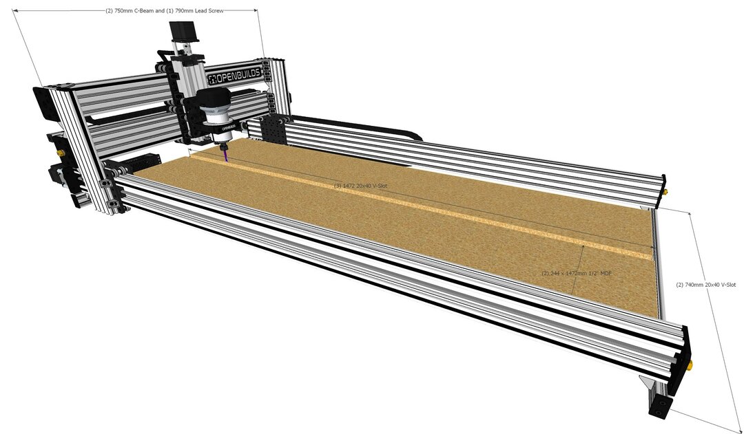

  12. Mark Carew
    2,745
    2,412
    Not a problem @jtadams glad to help.
    I agree it will be much easier to extend the Y axis later then the X
    So something like this is more what you had in mind?

  13. David the swarfer
    3,277
    1,833
    He could just connect it the other way, ie jumper the 4th driver to X and use the gantry as Y (like Crash used to do)

  14. Mark Carew
    2,745
    2,412
    Good point David, I didn't think of that. Good ol Crash, man I miss that guy. He was one of the good ones!
    I will say I do like the open front of this machine with the small foot print because if you put it on a table with wheels you could always roll it out away from the wall and using tilling do large though jobs.

    That’s perfect!! Exactly what I had in mind for the area I have to work with!!
    Would it be possible to add some sort of hold down (clamp or screwed) that we could mount to and tile an 8’ sheet of plywood? For instance, if the hold downs were faced in, they could screw/clamp directly to the plywood; finish first cut, unclamp then move it down 2 ft, re-clamp and repeat? OR if the feet were facing out or to the side, they could then be mounted to a 1x4 along the outside of the plywood - when first cut is finished, the plywood could be rolled down 2 ft, then clamp and repeat.. Thought behind this would be to take the machine outside and go HAM on full sheets of plywood. Would be setup under a carport on top of gravel..
    I like the wheel idea too! Could certainly make some sort of track on the long sides of the ply then just wheel this bad boy back and forth to tile the full sheet.
