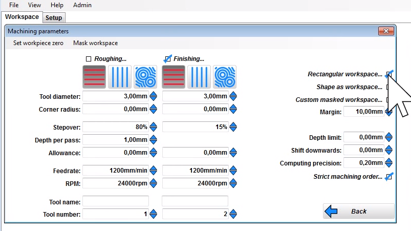

    I am talking about the gcode generation for 3D carving in estlcam that doesn't use the automatic 2 sided function but instead uses the setting each side manually method.
    I can get a screen shot, but I'd have to reboot into windows and make it and then come back here - so it isn't a 2 min job.
    here is a pic taken from a video of the screen i am talking about although this is the old version from esltcam 8 but the essentials are the same.
    I want to know how the "computing precision" parameter works.

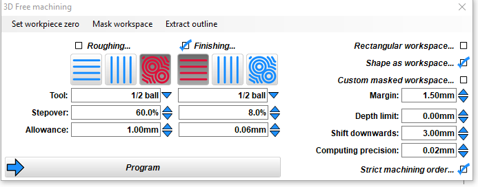

    here's what the 3D free carving dialog looks like in Estlcam 11

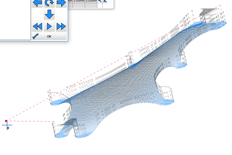

    and here's a screenshot of the toolpath showing the unnecessary Z axis moves

    It would be great to know why these extra Z moves happen. I have also noticed it with spiral drilling, and I think also 2D pocketing using parallel pocketing strategy.
  15. halfshavedyaks
    halfshavedyaks Well-Known
    Apr 10, 2018
    102
    Interestingly I don't see any unnecessary Z moves in the video above. So maybe there is a setting.

    After re-watching Christian's videos, it looks like sometimes there is the lift after each 3D pass and sometimes there is not. Wonder if it comes down to this setting...
    "Free machining" vs "Block Machining" I will have to try the free as I have always done block.
    One thing that can make all those lifts less painful is to optimize your machine for speed (figure out the fastest you can run your Z reliably, acceleration and mm/min)
    Another benefit to using "free" is that you can manually select the start point (I would love a "center start" option button), it's not pre-determined bottom-left like in "block"
    Big disadvantage of "free" is the loss of holding tabs!

    Estlcam decides about the Z moves in a "better safe than sorry" style and prefers to do additional moves instead of more complex checks or even risking a crash.
    Christian

    Ok, does anyone have any suggestions about how to convince Estlcam it is safe to not raise the tool?
    I will try some experiments with this in mind, when i get time.
