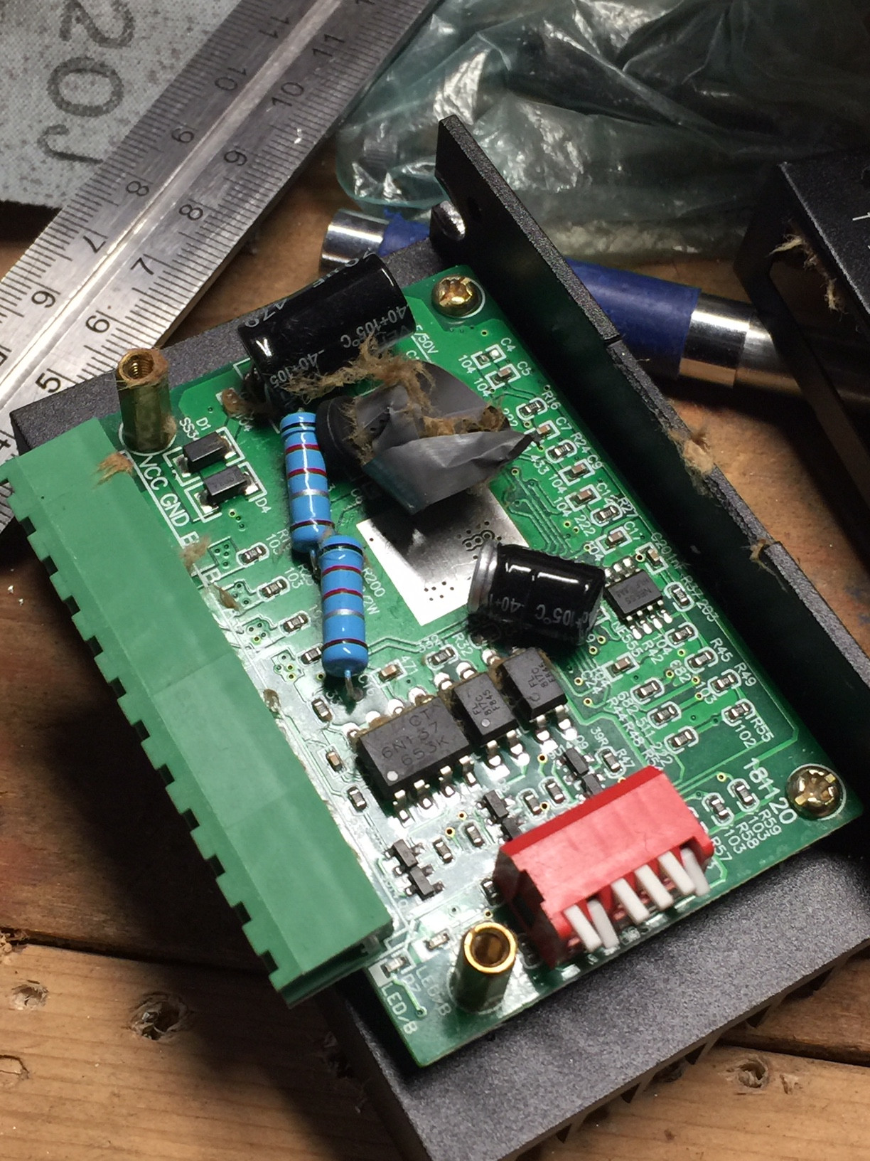

  9. Corey Corbin
    Corey Corbin Well-Known
    Feb 27, 2016
    135
    62
    Since we are confessing too fried drivers. I have to come clean I fried one too! Actually popped a capacitor. I think I mixed up the the 2 hots I was re wiring my controller board. And I think laid a positive wire to one of the drivers to be in series and pushed it to 48volts. I had 2x24vdc power supplies running 4 drivers. 2 per PSU. TB6600 drivers stated only 40vdc max. I heard hissing and then a pop. Kind of scared the tar out of me. Oh I bought some new drivers. DM542S. Steppers are much quiet then those TB6600's.[​IMG]
