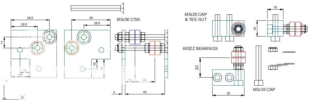

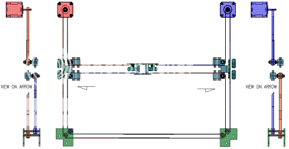

    Hi just curious if I could get a better picture of your timing belt apparatus for the X and Z axises. Looking to build a printer and want to know how you positioned them.
  8. alan richard
    Sep 27, 2014
    40
    Hi Noah.
    Excuse the delay. I've been away from PC.
    If you can get a CAD viewer like Autodesk's DWG trueView and have a look at the attached CAD file, that may help.
    I'll add some images for you, maybe later today.

  9. alan richard
    Sep 27, 2014
    40
    Maybe this will help-
    -a

    What was your reason for having one xy belt above (motor up) and one below (motor down)? I realize the belts need to be offset slightly but I would have chosen to have them only slightly offset on the same side of the xy plane but I may be missing something important. Since I'm currently ordering parts and going to build a very similar printer it would be great to have clarity on this arrangement.

    *The X & Y motor mounting - 2 of the screw heads on the steppers end up hidden in the top of the extrusion.
    It needs the motor fitted to the bracket first, then fix the bracket to the frame with hex screws & T nuts with a thin spanner between the motor and bracket.
    In answer to belt offsets - The idea was that one part of the belt loop on both sides would run inside the channel of the 40mm v-slot. One side in the upper and the other lower. which makes it 20mm spacing. If you bring the belt path away from the v slot then the offset can be any distance. One motor 'up' and one 'down' just worked out ok with the brackets I was using.
