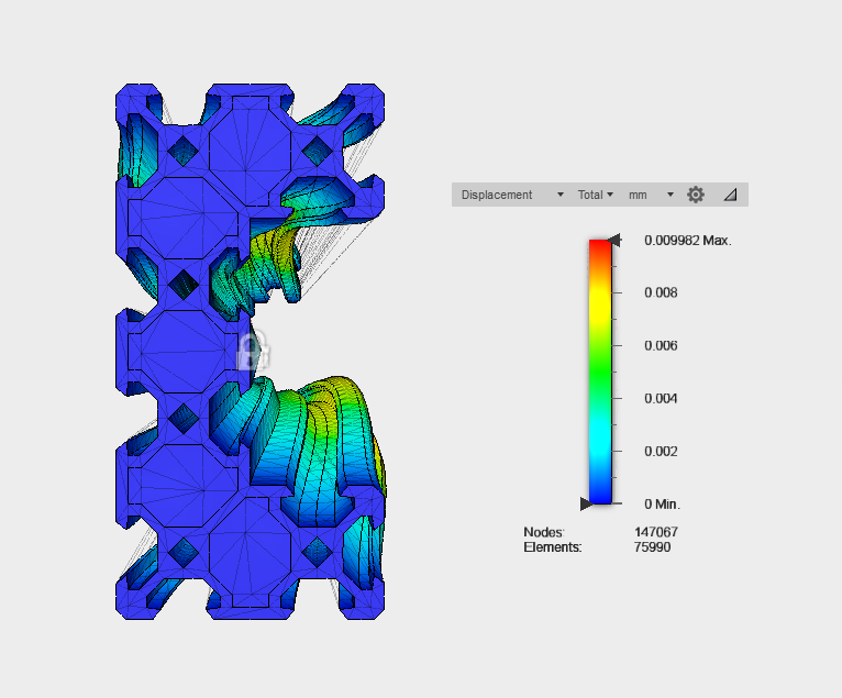

    Interesting idea. I ran some simulations and found that even modeling the epoxy as full cast iron only acheived a reduction in deflection by about 40% with the force applied laterally into the beam. I modeled the same test with a 1/4" plate of aluminum bolted to the back of the extrusion and achieved a 60% reduction. That seems like a better route to me but you of course will only be able to use one set of wheels. Something to think about. I would run some extensive simulations before investing any money into this. As many have said before, the main advantage of filling the extrusions will be resonance reduction which is still important but don't expect drastically stronger machines.

    I'm using Fusion 360 to model the results on a 750mm C Beames model I already had. I made the beam simply supported at the end and put a point load in the center of the beam of 15 lbf. The plain beam had a max deviation of .01", the filled beam .006" and the bolted plate .004".
    Hadn't thought of spacers for the back, even better.

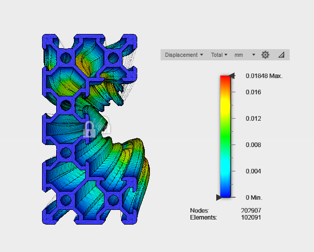

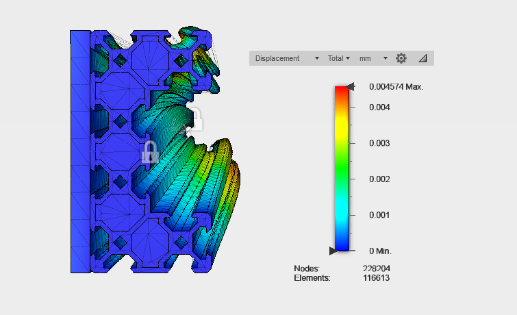

  19. EvanBruner
    EvanBruner Well-Known
    Mar 26, 2016
    68
    66
    Alright, the simulation took forever since my desktop seems to not like the simulation meshing...gets stuck at 80%. Had to use my laptop but I still got the results. The results are much the same as the point load of the original. Each beam was modeled with a 6600 Nmm moment about the center of the beam. This is roughly equivalent to a 15 lbf load applied 100 mm from the center line of the beam.
    Test 1: Plain Beam
    Test 2: Filled Beam (45% reduction in maximum deflection
    Test 3: Attached Plate (55% reduction)
    Test 4: Filled And Attached Plate (%75)
    Some issues with the results. I again modeled the extrusion fill as cast iron so the numbers are pretty optimistic. Also, Fusion models the contacts bewteen the filled sections and the aluminum beam as bonded with no seperation or sliding. In the real world, we would expect a small amount of seperation due to the effects of thermal expansion and, as these beams are farely slick its hard to say whether the epoxy will fully bond with the beam. Perhaps one could etch the insides of the beam with a lye solution prior to filling to promote adhesion.
    The simulation with the bolted plate is modeled with a .25" x 80mm 750mm 6061 bar fully adhered to the aluminum. Again, results are optimistic as bolting the plates will not give perfect bonding between the surface, but its a close approximation.
    These results make the filled beam look more promising if you can find a low cost and high strength filler for the beams. The bolted plate is only 3 lbs of material that can be had for $20, but will require more hardware to allow the use of double wheels.
    To get the best results possible, you could bolt the aluminum plate to the opposite side of the beam and fill the beam with filler. You would have to find a solution for mounting the lead screw, but you would be eliminating the weak point of the C Beam, the channel to house the leadscrew.
    Moag and Joe Santarsiero like this.
