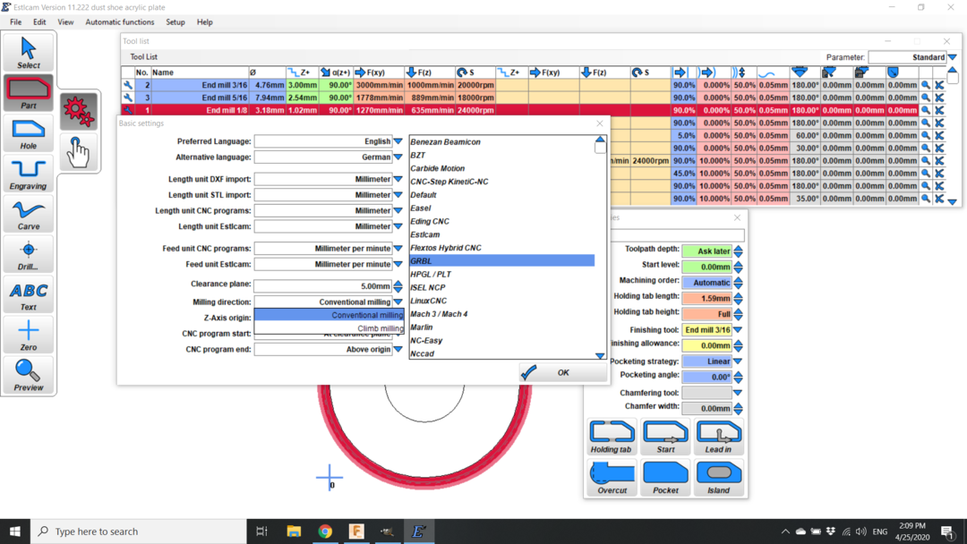

    Estlcam is easy to use, but sometimes. Far easier than Fusion 360 if you are just doing simple 2.5 D work. You can choose climb vs conventional when you set up your controller. There is a free version that is identical to the paid, but it may be "slowed" down a bit. But if you like it, it is well worth the money ($59). Estlcam: 2D / 3D CAM und CNC Steuerung...

    If you have Estlcam questions, there are a few of us on here that use it so ask away. If I do not know the answer, I will help you find it because it helps me learn more about it as well. I use it all the time, but for simple projects. I have yet to try trichoidal milling, or some of the other more advanced stuff.
