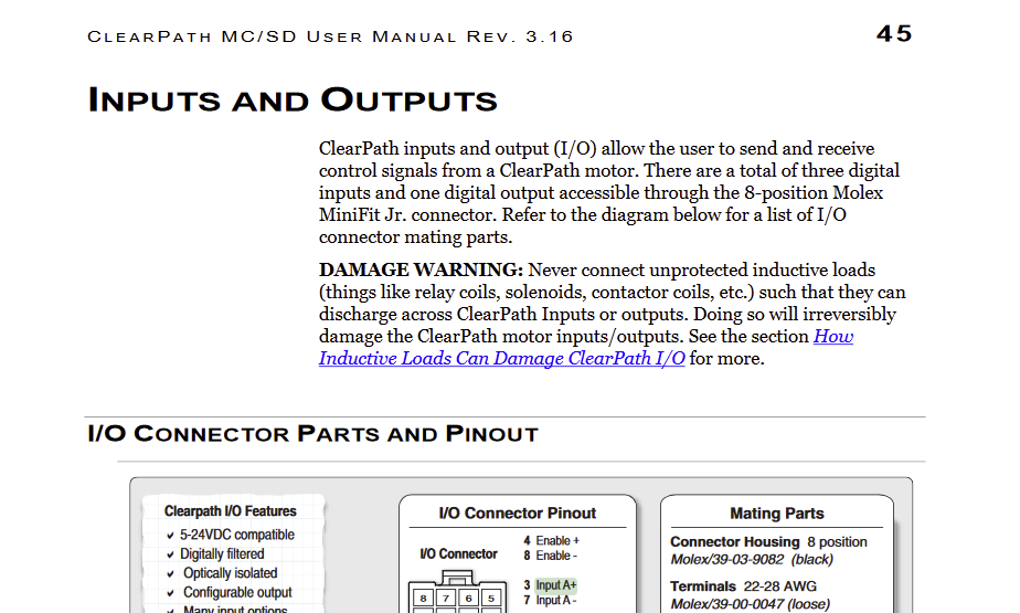

  28. cnc machinest phil
    Sep 7, 2017
    28
    But the clearpath servo has an extra wire, HLFB+, INPUT B+, INPUT A+ ENABLE, and 4 others that all go to ground. And these are separate from the power cable. The steppers I had only had 3 signals that went to the tb6600 to control the power which did have 4 wires - 2 for each set of windings. I am no longer using the limit switches as the auto tune feature on the SD servo's can use hard stops. That eliminates a lot of wires etc.
    I guess what is throwing me is the INPUT A+ and B+

  30. cnc machinest phil
    Sep 7, 2017
    28
    yup sure did many times on page 45 and others including some teknik videos. the only one that shows wiring is the one video and it just uses the arduino to spin either direction using the msp program. quite a bit different than precision moves required in g code and cnc.
