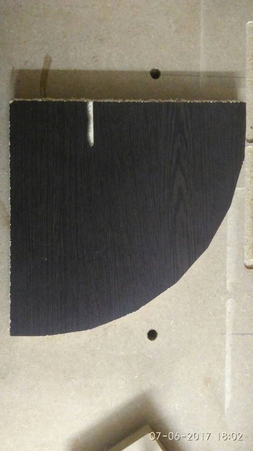

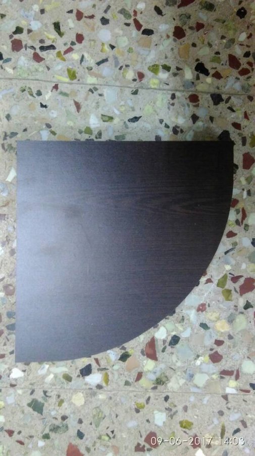

    I have tried sketchucam which does the circular profile without any problem, when I generate tool path from fusion 360 it does not show any problem while simulation, but when I machine it circular profile comes like a polygon. Not able to identify the problem...!!! I am using grbl 0.9

    Are you drawing this part in fusion? Does your gcode output have I J K or G2/G3?

  3. vikramprasad
    Jan 3, 2015
    Yes, I have drawn and generated the toolpath in fusion..I have attached the fusion file ..
    This is the g code

    what GUI are you using?
    Why is GRBL not complaining about the Tool change codes in that file?
    maybe the GUI is converting the arc for you?
    I say this because the arc is one piece and GRBL should not have a problem with it.
    you would be better off with this post processor
    GitHub - Strooom/GRBL-Post-Processor: Start
    which does not output toolchanges and other things GRBL does not handle.
