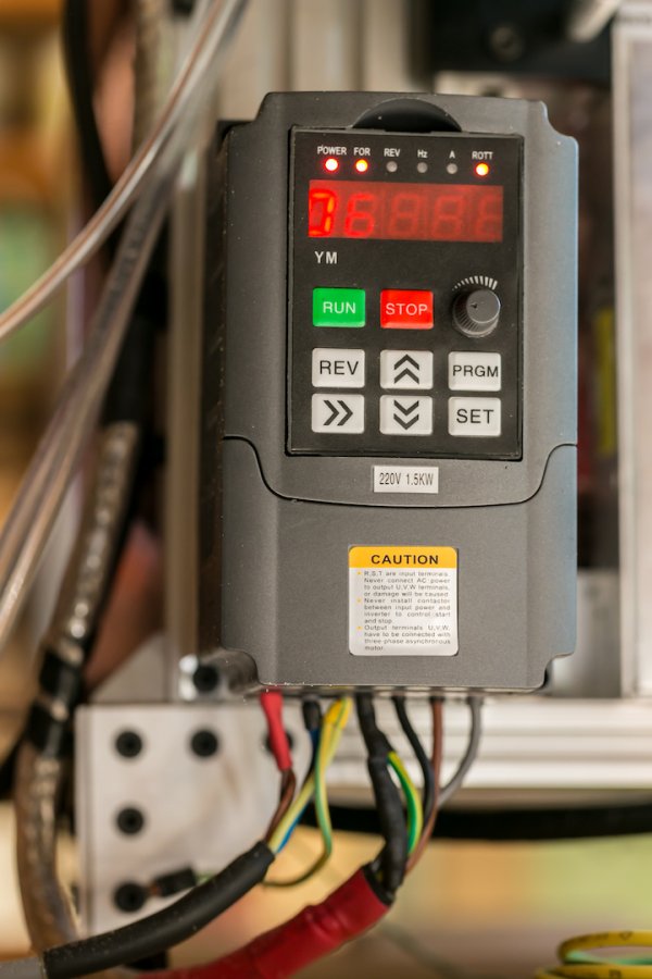

    On you guide, it say s check PD 177 to 180 however i got these messages
    pd177
    p178
    pd179
    pd180
    Any ideas what they mean??
    Thanks in advance
  6. Moag
    Moag Veteran
    Mar 16, 2016
    183
    288
    G'Day @sunil, not being a distributor or manufacturer of these, I can only guess...
    pd177 - ELun means?? Low voltage at constant run speed
    pd178 - ELud means?? Low voltage at deceleration
    pd179 & 180 - EErn ???? don't know, but for other EE errors, they suggest to send it back to the factory.
    So all I can suggest is,
    • make sure the VFD and spindle is rated for your countries voltage
    • check it's wired correctly with suitable wire
    • all the suggested PDs are set as they should be
    • While you're at it, go into PD172 and set to 01 to clear the recorded faults in PD 177,178,179 &180
    • Turn it off at the power point and give it a couple of minutes before turning it on again. give it a run without cutting anything and check for errors again.
    • Record the error/s again if they are still present in PD 177, 178, 179 & 180.
    • If still present post them here and we will go to the next step.
    Let us know how you go...

    ive got a 1.5kw air cooled spindle and a 2.2kw vfd
    i have swapped the input into the vfd as i read last night that 'T' should be used as the neutral and 'R' as the live and now no error messages stored in pd178 to 180
