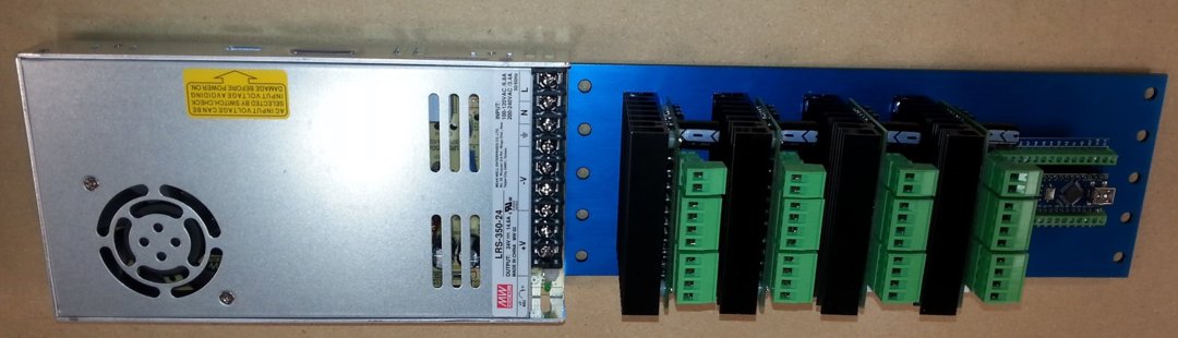

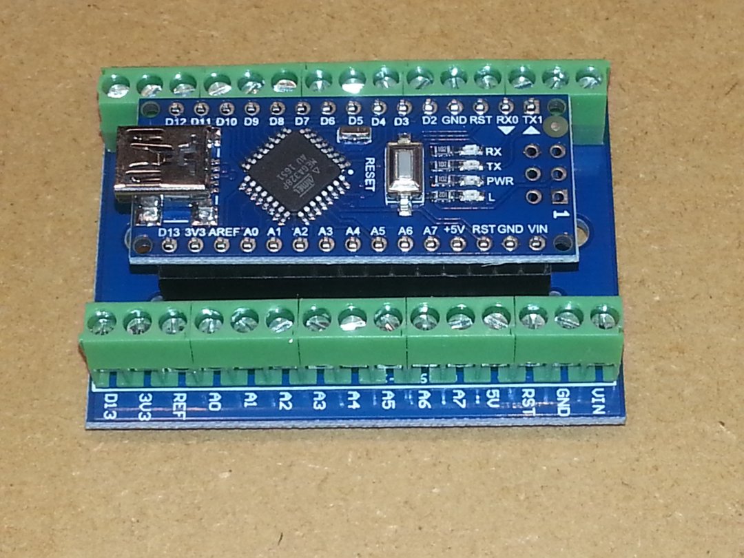

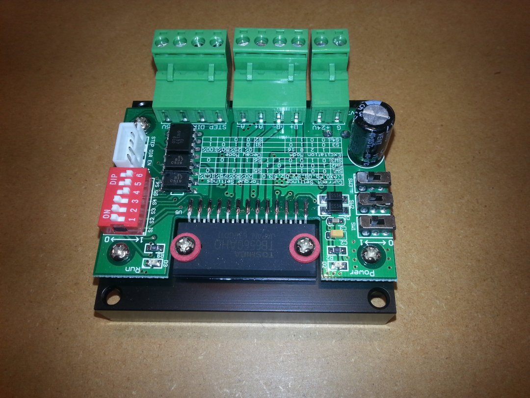

    Here is a photo of the electronics package I use in all my machines. This particular one is not wired yet. It mounts on the back of the X axis gantry (with a plexiglas dust cover) to minimize wiring:
    The 4 pin plugs at the bottom of the drivers go to the Nano outputs, the 4 pins in the middle go to the motors, and the 2 pins on top are wired individually to the power supply through 5A fuses.
    MG
